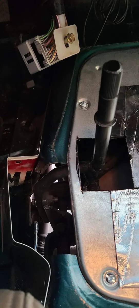

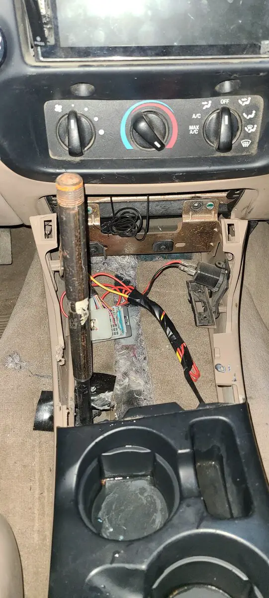

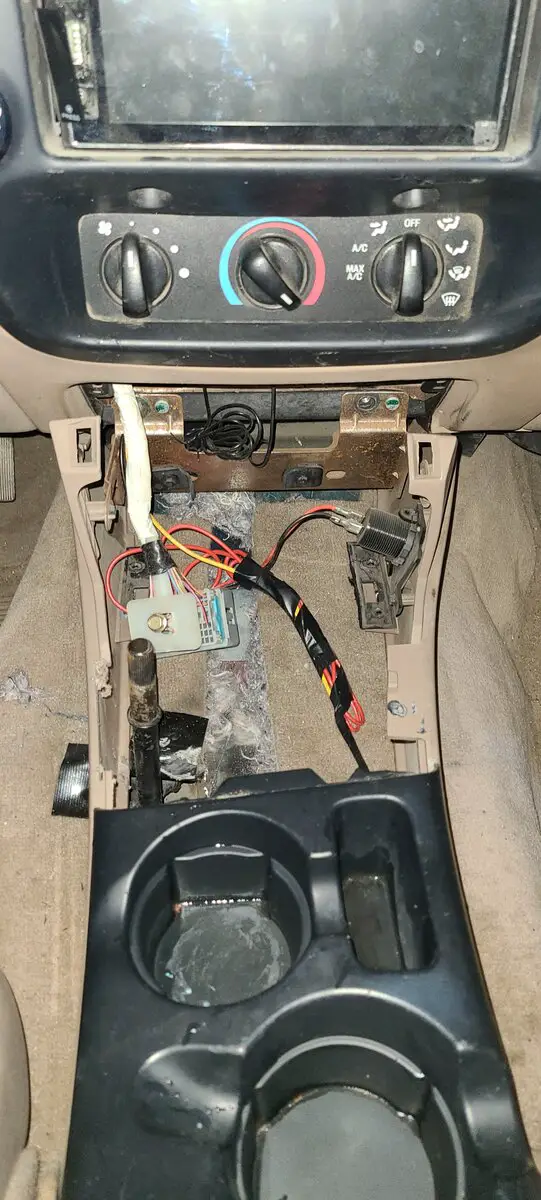

having a shifter stick up beside the console would be really uncomfortable. So I modified the shifter to "dogleg" to the right coming up into the console.. of course the mechanism still moves into the wall, so a little fabrication was needed.
I still have room for the cup holders, still looking into modifying the rest.. and the pipe is a short term answer for an extension..
