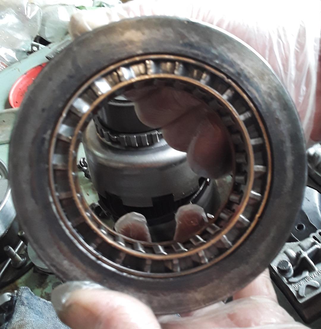

I have been working on my A4LD in my 1992 Explorer of and on for the last few weeks. I never could find my ATSG Manual for the A4LD transmissions. I resorted to the 'lay all of the parts on the table' method. There is one problem though. When I turned the case over gently to get the low/reverse drum out, one part out of all of them got out of order. I reassembled the transmission but just wasn't happy about it and now I have it apart again. Below is some pictures with descriptions.
The first picture is the 4.0 A4LD low/reverse drum. 2.3 and 3.0 transmissions are different. There is a top brass piece and bottom piece that I don't know the name of.

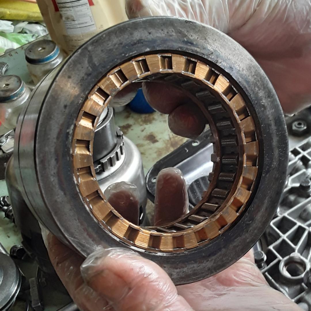

Here is a picture of the drum flipped over. I think the brass ring on the bottom goes this way even though I had it the other way the first time.
On the bottom, this is the way that I had it the first time.
Which direction does it go?
