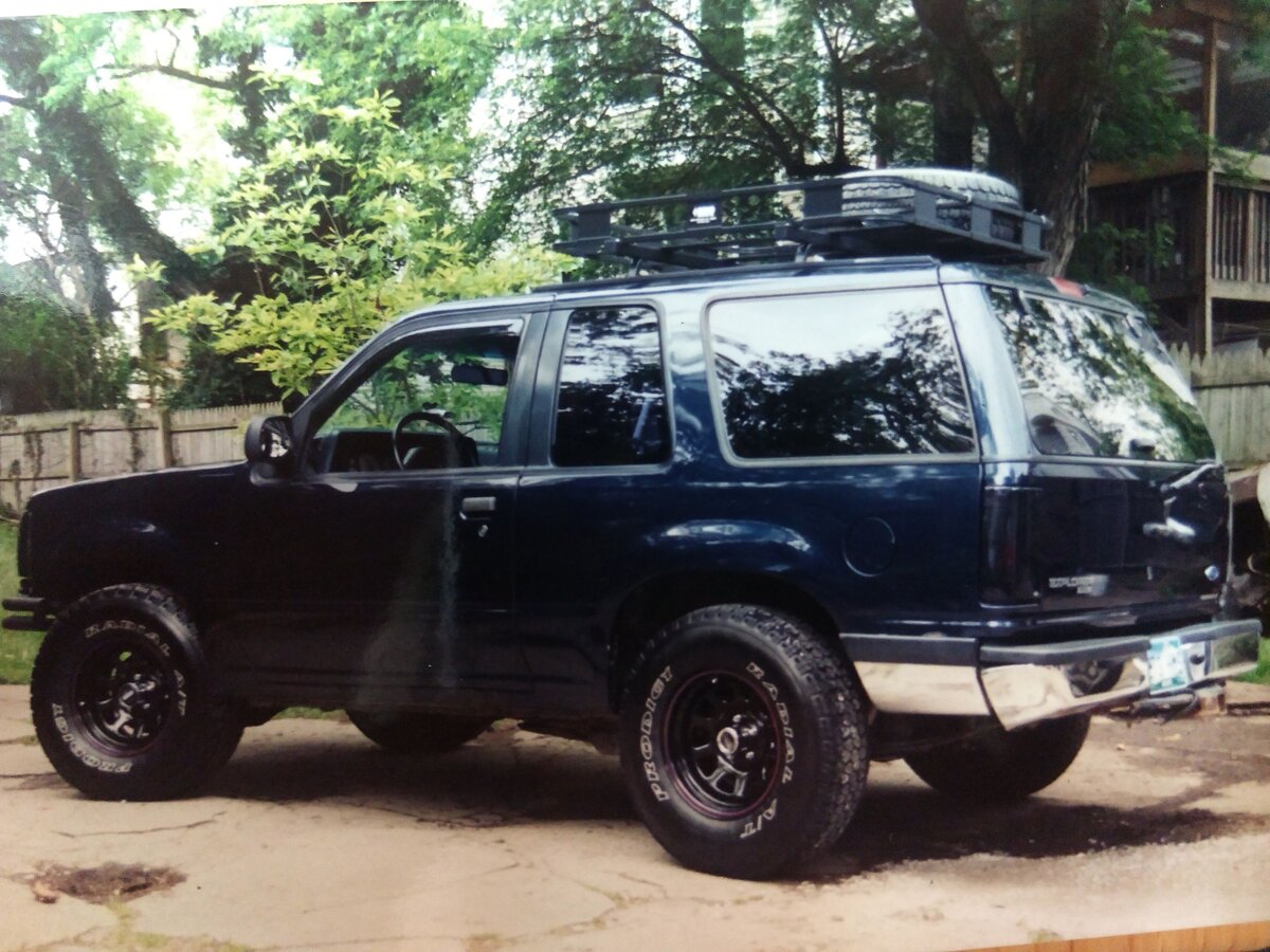

This was taken back in 02 after putting the wheels and tires on. I bought it when it was just 10 years old. It's hard to believe it's been that long ago now.
