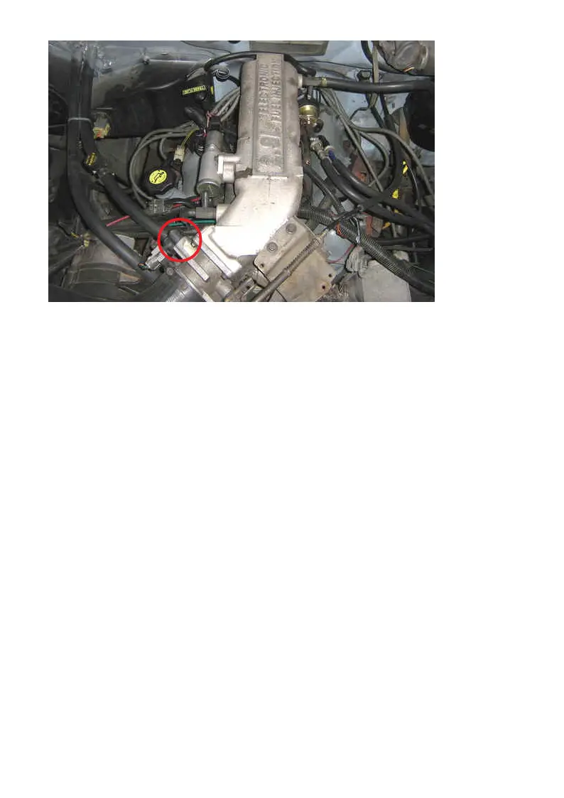

I wanted to check the throttle valve and I put it back wrong , the accelerator was fully open , when I started it went up to 7000 rpm direct , it only lasted a second but I think it was enough to break something in the box
