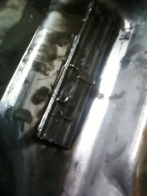

well i pulled the pan... and sure enough the 3-4 shift solenoid is burned...no biggy got a spare still... but its the metal shavings i found in the pan...
im sure this contributes to the loss of drive gears.... idk what to do at this point im far from comfortable tearing into the trans intest to rebuild it... i can will do the vb but thats as far as i can go... any ideas guys? what could these shavings be from? there wasnt any noise any grind anything at all...am i screwed and yet again need another trans or a rebuild or is there a possibility it can be something mild...reverse works fine...when i shift it into drive and any other forward gear it acts like its in neutral...no grab and slip..no engagement... it kills me to say this but i think im to the point of selling my X even tho i just put all the time and money into the lift and axles and all that...i just dont know what to do... i wanna keep my ex but if every used tranny i put in is gonna last me 100 miles im done for and cant afford to rebuild one... thanks in advance...
