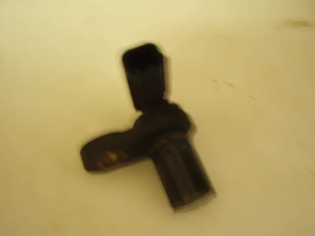

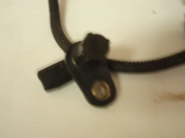

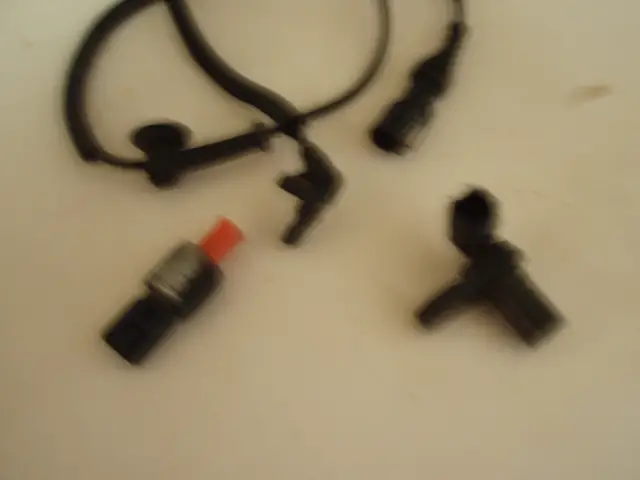

YES looks like the one i just put in my '04. . . .
The FIRST pic looks like, holding in my hand, ill post a pic.
The Amazon looks correct.
PN on box 5L2Z-9E731-B still good.
Bottom Pic its in the bottom right corner, with the pressure switch, and a front.

This abs stuff is really getting on my nerves...the part does not fit the explorer...I went to the local Ford dealer and bought one for like $45...the $17 buck version is for the Sport Trac Explorer not for the SUV...I guess that I'll have to send the sensor back to amazon for a refund...the shop is now closed so can anyone help me where can I find the sensor to plug the original and new motorcraft sensor? This should work now!!!:rolleyes:
Here is the pic of the incorrect sensor:
http://i725.photobucket.com/albums/ww251/superfestiva/DSC00341.jpg
Left is the correct size, right is the one received that will not fit...
