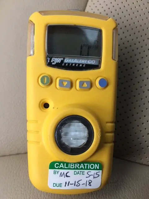

Your point is well taken as most of my measurements are in the 8-17 ppm range. However, I measured 114 ppm carbon monoxide on January 21, 2018 in passenger seat area, and gave Ford a picture of the meter display. Currently trying to determine if the meter was cold and caused a false reading or if the reading is legitimate. Will advise of test results.Not only that. that device starts at 100PPM... ****, it will never go off in the Explorer.. they haven't measured anywhere near that.
I agree with the issue of the GULI meter not starting to alarm until it gets to 100 ppm of carbon monoxide, is not satisfactory. However while I was looking for a CO meter that has a data logger; I saw a meter update where the GULI has a second generation meter that alarms at 3 ppm Carbon monoxide. Maybe the second generation meter might work for detecting for CO in the Explorer.Not only that. that device starts at 100PPM... ****, it will never go off in the Explorer.. they haven't measured anywhere near that.
The dealer held onto the Ex for 50 days, during that time a field service engineer inspected the vehicle and did not find the Ex to be out of compliance/no trouble found. The suspicion that the carbon monoxide meter may have been cold is a concern, so I will keep the CO meter in the house until we go out in Ex. When the field service engineer went out to test drive the vehicle, it was cold and windy, so if I had to do over again, I would wait until a warn and calm period to get the Ex inspected. From here forward, I bought another carbon monoxide meter with a data logger, so when we go out, I set the meter to sample every 10 seconds for up to three days maximum, I set the alarm LED to activate at 10 ppm. You have to start and stop the meter by plugging it into the USB of your computer. So I will start and stop the meter every three days and record notes of when I drive the Ex. It downloads the results to a chart showing CO readings over time. Consequently, I will collect chart data over the coming months that shows how much carbon monoxide and how long it last before I have to put the windows down at each occurrence. I put a note on my calendar to follow up at the end of Sept 2018.Your point is well taken as most of my measurements are in the 8-17 ppm range. However, I measured 114 ppm carbon monoxide on January 21, 2018 in passenger seat area, and gave Ford a picture of the meter display. Currently trying to determine if the meter was cold and caused a false reading or if the reading is legitimate. Will advise of test results.

I'm in oil/gas, and have utilized this model in the past too. I own one and have been keeping it in my 2017 Explorer since I purchased it new a week ago this past Saturday. Thus far it has registered goose eggs which is what I expected. Am not knocking those who believe they're affected by CO in their Explorer thus I'll keep it in my vehicle just to keep an eye on any potential issues since I'm hauling the grandson quite a bit.

Wow that's pretty high.
