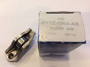

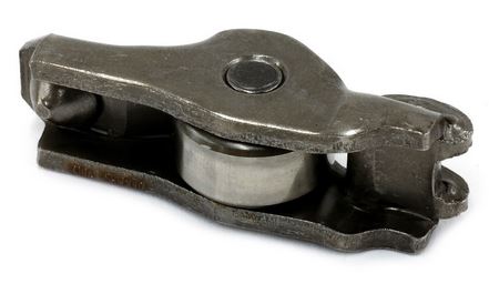

For us, this story begins in 1997 with the first of the 4.0L SOHC engines being sold in the Explorers. Ford used a "Rocker Arm" part number F77Z-6564-AB in the first of the SOHC engines (1997-1998ish), which was very similar to the follower used in the 4.6/5.4L 2v and 4v motors, but with no oiling hole.
Original 4.0L SOHC "Rocker Arms" (cam follower)

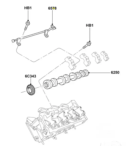

This is the oiler feed line [part 6578 above] and this is an indicator of an early 4.0L SOHC (1997-2007ish).

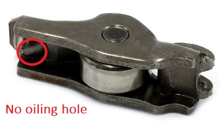

These engines have followers with NO oiling hole from the valve adjuster ["lifter"] - see the top picture.
**I REALLY cannot stress this point enough...
Some time in 1998, the F77Z-6564-AB was deprecated and the YL2Z-6564-AA was the authorized replacement for ALL early SOHC engines (with the oil feeder line on cam towers). The F77Z part was prone to flexing and could jump off the adjuster and even has been known to break the Cam Position Sensor finger off the camshaft:

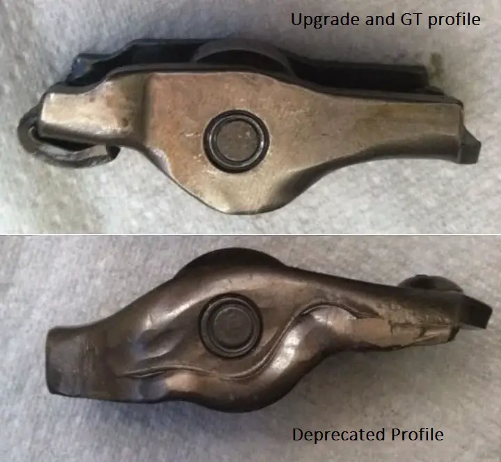

Here is an edited image found on the Interwebs that compares the side profiles of the F77Z and the YL2Z and GT (see below)
GT Super Car, GT-500 Followers:

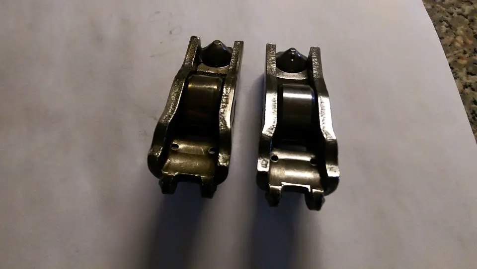

On the Left is the follower from my 2005 Sport Trac (90 grams), on the right is the GT SuperCar/GT-500 follower 4G7Z-6564-AA or Ford Racing M-6529-MSVT (90 grams) - difficult to see, but there is a TINY oiling hole on the right follower. These followers are also hardened (like the YL2Z) so there is less flex and wear.

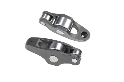

And finally, the "Big Dog"! The Jesel Ford Modular Follower - FULL ROLLER.
