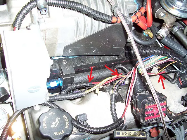

Isolated injectors
After removing the coilpack I was able open the main loom enough to access the wiring for injectors 4, 5 and 6. As I suspected the control wires from the injectors to the PCM are present. However, the power source injector leads are all wired together but not to the source.
I think I originally had planned to splice the IACV source to the injectors but the IACV was one of the last things wired because I hadn't selected a box for it. I must have just forgotten. The plugs don't look heat damaged from running lean but I only have about 200 miles on them. I've been careful not to exceed 5 psi of boost and have avoided high engine speeds at WOT. Burning premium fuel and the knock sensor retard seems to have prevented detonation. Today I spliced the IACV source wire to the common injector source wire and started redressing the wiring harness. I'll try the resistance test tomorrow but won't bother with a 12 volt test. I should be ready for an engine start Monday using the original tune calibrated for six functional injectors. I'm anxious to see what my wideband meter reads.
