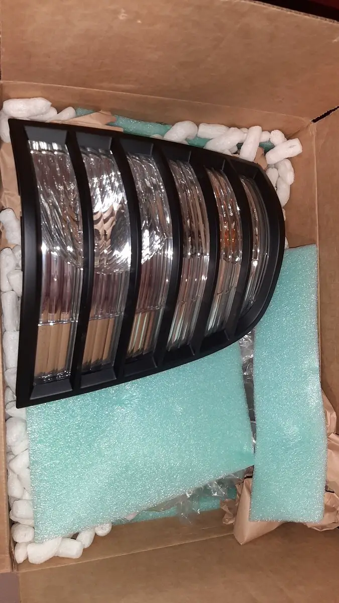

just to follow up on this old thread- I ended up installing a set of 02-05 tail lights in my 08 Limited.
Love the look over the factory 06+ tail lights. Only wiring involved was for the backup lights. I went to the local junkyard and bought a set of the 02-05 backup light plugs and then bought a set of 194/T10 MALE plugs and made an adaptor so now its all plug and play.

sorry for the late response on this.... this is the way i did the wiring. I went to the junkyard and cut 2 02-05 backup light sockets off a junker.
then i ordered 2 T10 or 194 MALE plugs.
Soldered them together to make it all plug and play. This is all you have to do. The top plug on the 06-10 light is just taped off. You do not use it. The plug that comes on the 02-05 aftermarket LED light plugs directly into the 06-10, and then you plug the adapter i made into the backup light socket and use the larger style 02-05 backup bulb.
