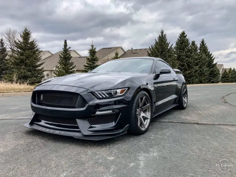

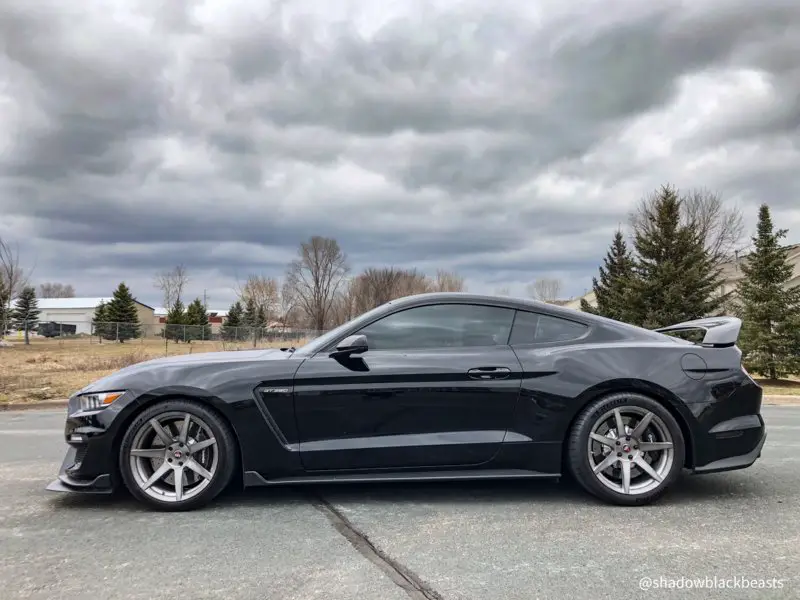

i mean.... top view, straight down, you can see the top of the tire. not legal, doesn't look good, and with the offset skewed that far to the outside (enough to increase the suspension clearance even with a wider tire) you are likely to end up with a positive scrub radius, which isn't going to do you any favors, handling wise, on uneven surfaces.

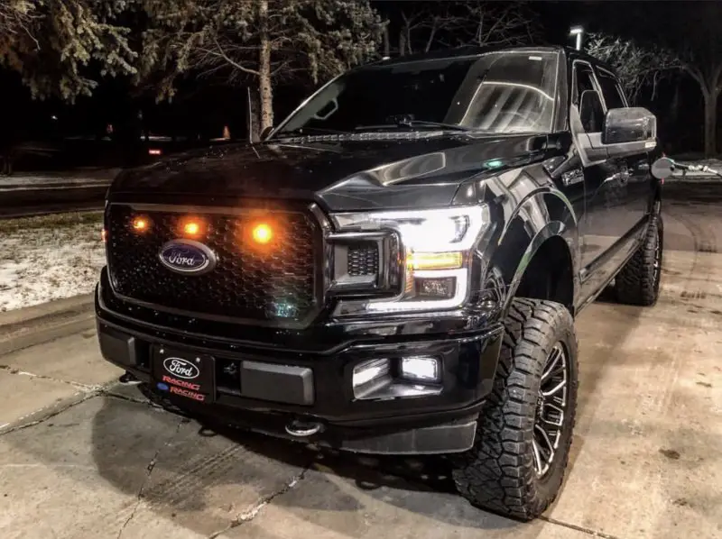

I completely disagree but that’s the beauty of car builds everyone can build them exactly how they like them. And I live in Minnesota everything is technically legal MY F150 sits on 12.5 wides with a -40 offset. Understanding how suspension works once the car is dropped about an inch and a half and a proper alignment is done the tires will sit flush with the fenders. And moving the tires flush with fenders adding 20mm of rubber to a track spec’d SUV increased handling not the opposite. But constructive criticism is always welcomed :)

Past builds (Shelby and F150 still in the garage)working with wheels and fitment for a long time so I know exactly where I want this one to end up with the big picture in mind.

I'm usually not a fan of aftermarket rims. I'm very picky but have to say all of these look fantastic on the vehicle. I am not a fan of the ones on your ST, I think it is just the style of the rim but props to you on the others!!
Looking at it, maybe it is the shadowing but it looks like the rims are pushed in (spokes) too much and the rubber is too wide for the rim.

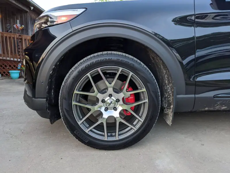

TSW Nurburgring w/ polished machine facings. The barrel is soft gray as are the flats of the tuning forks. Bought them at Discount Tire. Ordered them last thursday, they came in this morning. No fitment or balancing issues. Getting positive comments from strangers when I've stopped for gas, the grocery, etc.
Nice set of wheels ... enhances the brake caliper.
Yup. It really makes them stand out. The sun was going down when I took the pictures a shot time ago. That's why the lighting is flat.
