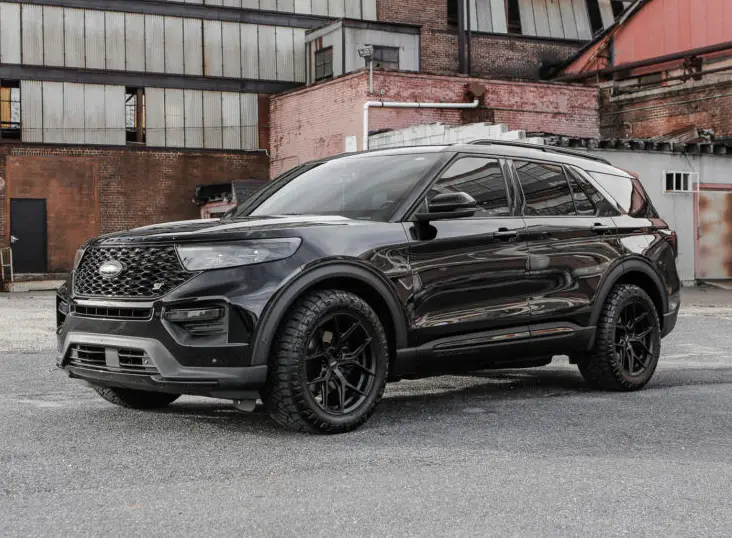

Konig Wheels SS88514355 Konig SSM Gloss Black Wheels with Machined Lip | Summit Racing is there any reason i cant run these with relative stock size tires? i want a little more pushed out wheel but nothing crazy. just going to run stock size tires with a at tread pattern. whats the factory offset pos45? these are pos 35 so they will be just roughly a half inch deeper offset. or should i step up to the 9 inch wide with the pos 22 offset? i want it to fill the fenders but not stick out past.

do you know the offset of those? i want it to just fill the fender like that but i want to run a 18x8 or 18x9 wheel.
No, I can't find that information on the website. It's in Vossens own gallery.
so it looks like the 20x10 vossen come in a+45. the 20x9.5 in +25. and the 20x9 are in +32 or +35. so it has to be the 9 or 9,5 inch wheels. i just wonder which it is?
From the picture, I am 95% sure it's the 9,5 in +25. But I'd ask Vossen to be sure.
