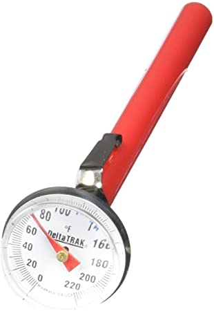

Let us know how it turns out - do a before and after with a vent thermometer
I used to permanently leave a vent thermometer in the center vent so I could compare the A/C air temp coming out VS the outside temps.
My Ex was able to get down in the low 40's on days over 100 degrees -
I leave my digital thermometer in the center vent. Its a good check. You will know what is is and see any changes when they hsppen.
