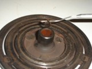

Clutch Gap?
Did you already check the clutch gap? I'm asking because I'd had warm air from vent when stop at light or on heavy traffic. And after a while... cool again. I don't know about high and low pressure - I didn't check and I'm not able to had an argue about it. But in my case, just took off one spacer and A/C works fine!

I havent checked that! I've had the clutch off a couple of time but never noticed any spacers but it seems that they are inside the clutch past the splines. I'll check the gap on mine. I'll report if this works or what I needed to do to make it work. Thanks for the suggestion.
well to eliminate any issues an not having to start over I did both suggestions. I removed 1 of the spacers which brought the clutch spacing into spec. I was showing more than .75mm which is way to much. now I'm at .40mm. I also drained all of the oil out of the system and started over. 4 in the compressor, 3 in the accum. and 1 in the condenser. Overall I added about 29oz of 134 and Its blowing ice cold and doesn't seem to "load" like it used to. I actually got it to start to do what it did before were the compressor seemed like it was struggling (not nearly as much as before). I got my wife to put the truck in drive and hold the brake. (this is when the air used to go warm) well no longer, and the pressures measured 200 high and 38 low, 75 ambient outside. So its not really the compressor overloading the system, its the engine loading trying to maintain the load of the compressor. With a properly charged system and a fully engauged clutch, the air never goes warm when stopped at a light. :D
