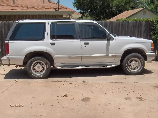

Why not just put some longer shackles on your leaf springs? That's what I did to take the sag out of my 94 and it works great, wasn't expensive either cost me 17.99+tax at autozone, and only took about 20mins to install
how did you get the longer shackles do they sell a kit or do you have to order them for a different vehicle
Here's what it did for mine
Before the longer shackles
After the longer shackles
