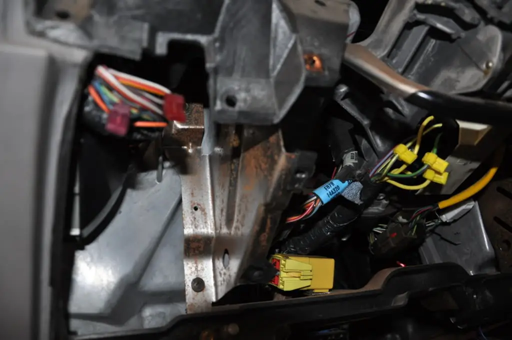

this is all I have available, I can take more pics if needed.
I found where the alarm was tapped into the starting circuit. the blue/red wire that runs from the ignition to the power distribution box(?) under the hood was cut and the alarm was spliced into it.
correction: I had two alarms!!
alarm 1: Loctronics- it was wired up to the aforementioned blue/red wire and simply had a "key" that could be unplugged and kept on your person to insure the car cannot be started. I think. I'm just guessing thats what it did.
alarm 2: "Car-pro" - looked like a typical alarm; it was hooked up to the door locks, a "shock sensor", and a horn-like speaker. this was also tapped into the big yellow wires running under the steering column. this particular system was a piece of crap! when I unlocked my doors using the remote, it would cycle the locks two or three times as opposed to just one click. it also didn't respond correctly to "shocks" or bumps, and would only go off if I opened the door without disarming the alarm. :frustrate
I'm not sure what I'm looking for to troubleshoot. thanks for the help!
