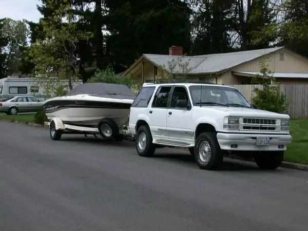

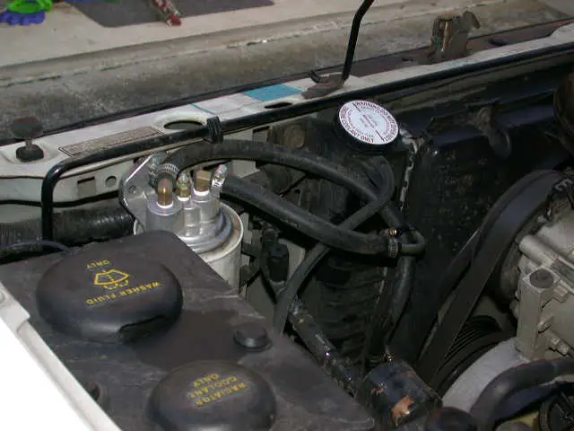

Over that summer we decided to get a new boat that was considerable heavier than our first and this forum lead me to be concerned for the longevity of my tranny. Rusult, a temp/filter mount and associated temp guage
Along with a second aux cooler.

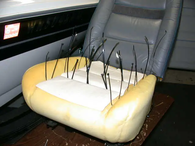

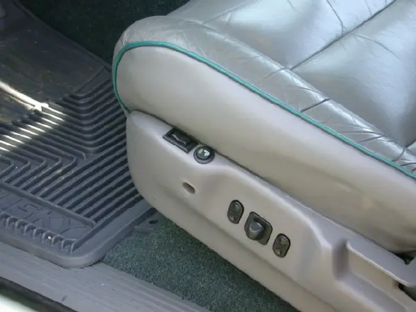

Winter brought cold leather seats and I am disgusted with the cheap sheepskin covers. I found some info here about installing aftermarket seat heaters. $85 and 4hrs per seat later, we both have warm butts :thumbsup: The wire ties replace the origonal hogs rings.

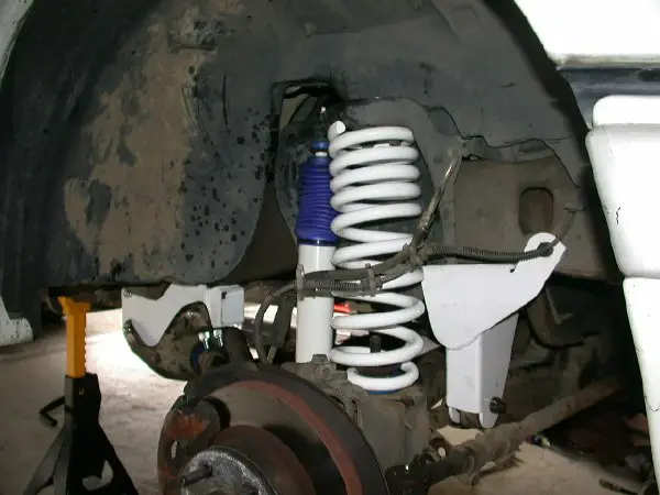

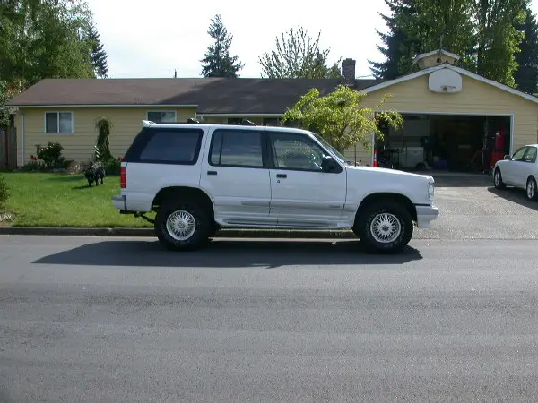

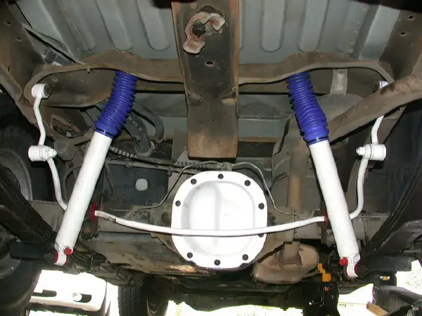

Next came numerous conversation with Bryce and Joe about various methods of lift and the decision was the James Duff stage 1 2.5" kit. (which I sent to a local powder coat shop to make them white :D ) I opted for a whole new 3" lift leaf pack instead of the shackles and AAL's (sold them to Greenbeer)

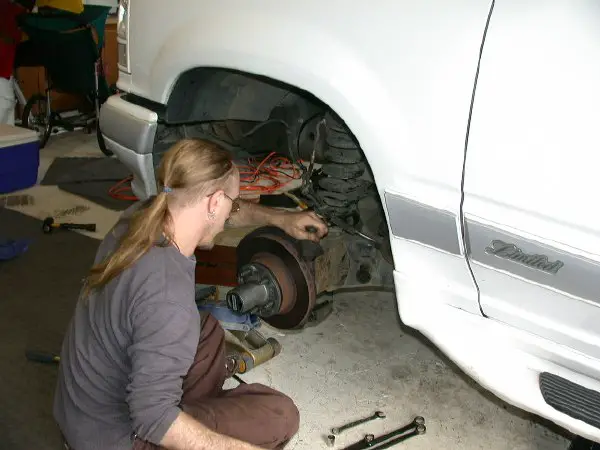

Joe was kind enough to offer to 'rub out those rivets' and I eagerly accepted and drove 2 hours South on a Tuesday evening. This would make installing the lift a much easier task.
I started by taking the sway bars off on Thursday evening so I could paint them ----- (guess ;) )
Friday evening I pulled the shocks off the rear and hit all the bolts with WD40 for the second or third time in preparation for a long Saturday.
Dreamr offered to come over after his significant other woke up from a night with the girls and again I accepted the generosity of fellow X owners.
I started at 9am and had the rear complete (sway bar and everything) by 10:30. The only difficulty I had was Carrier put the spring pack bolt on top in stead of the bottom. 10 mintues with a dremel grinder and the bolts were round and the axel sat right down.
Next was the RA drop brackets. I had both of them on and was torqueing (sp) them down when Bryce showed up around 12:45.
We proceeded to the axel pivot brackets, then the new springs, new shocks (oh by the way, after the generous ride with Joe at Evans Creek, I opted for Rancho RS9000X's for thier adjustability over the JD shocks (there's another story there). Last was reinstalling the front sway bar.
We went around all the parts and pieces and re torqued them, popped a barley pop, looked at the clock and it had just past 5 :thumbsup:
Thanks tons Jrgaylor (Joe) and Dreamr (Bryce)

I put the seat heater switch next to the Lumbar switch.

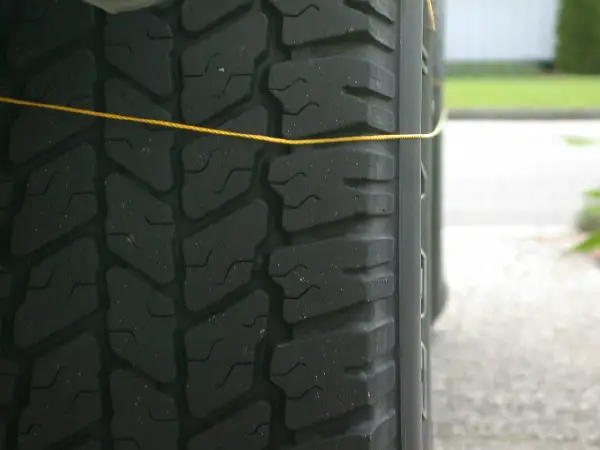

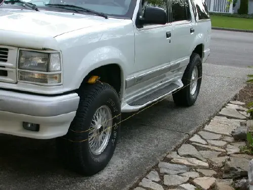

When I went to Starbucks this morning, I discovered the toe in was WAY off, especially the left side. :(
So, a little string ;) , a few turns on the adjuster barrel :eek: and we're driving straight. At least long enough for the suspension to settle before getting an alignment.

It looks even prettier in person than the pics :D
I chuckled when Phil said he was powder coating it all white, but in the end it looks really nice!!!

How exactally how do you check you toe with that string method? I wanna try it. I know Im off.
Ryan
Looks good P, :thumbsup:
Ryan1 said:
Good job.
Ryan
Center your steering wheel, loop a length of string around the rear wheel and run it forward around the front wheel. It will work better if you string both sides at the same time.
Now look at how the string contacts the front tire. In the first pic, i'm nuetral (string touches front and back of front tire) if your toe out, the string won't touch the back of the tire. If your toe in, the string will bend around the back of the tire (which you want a little bit)
Make some adjustments, unlock your steering ( don't need to turn the engine on) and rock it back and forth a few times then recenter it. (unless you have caster pads like the alignment shop). :thumbsup: :navajo:
makes more sense now. Thank you, im going to give it a shot.
