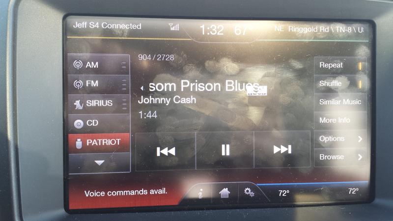

Today I started experiencing an unusual problem with the album art being displayed from my USB drive. The album are on the main screen was small, scrunched (wrong aspect ratio) and was misplaced too far to the left.
Here is a picture, you can see it is small and moved over behind the text:

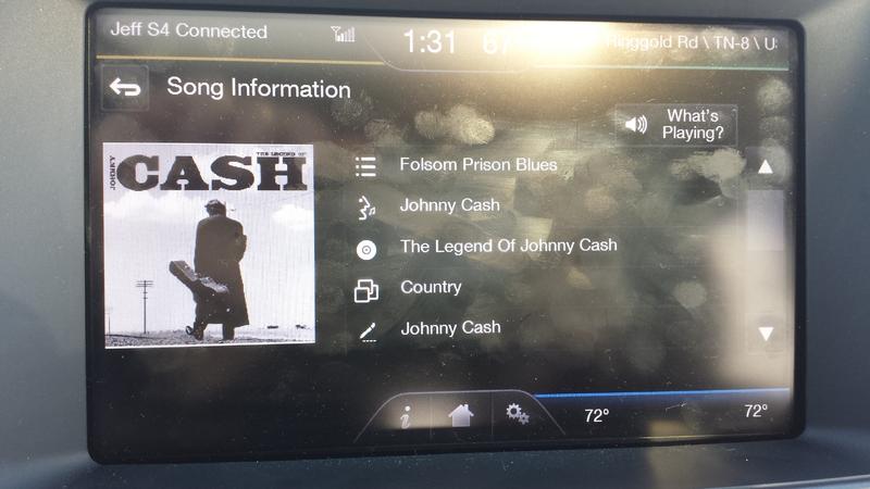

If I select more info on the song, it displays fine:
This issue sprang up out of nowhere. No MFT updates for several weeks (on the latest 3.6.2) Several days ago I added some new music, but today was the first time this happened. Could be a corrupt album art caused the issue when it tried to be displayed.

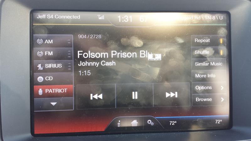

I tried to restart the car, I removed the USB drive, re-indexed the USB drive nothing worked, UNTIL I used the MFT reboot app. Hope this post will help others if they experience this. (I am sure I am the only one, its just my luck)
Sync rebooted, restarted and the album art displays correctly again!!!:
Does anyone have any insight to why this happened? Was it just a bug or glitch or do I need to scour the album art of 2,000 songs to find out which one caused the error. Just glad the fix (or temporary fix) was to use the reboot app.
