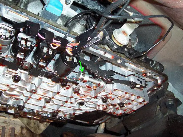

I was having problems with the shifting in the 1998 Ford Explorer Eddie Bauer. It was revving up and not shifting and then I would have to lower the RPMs to 1500 RPMs and it would shift. Dropped the transmission pan and the filter, dropped the valve body and found I had a blown gasket. Replaced the gaskets, put the valve body back on, put in a new filter, put the pan back up. Filled the transmission fluid. And now I have park and 4 Forward speeds. I don't know if they're all the same gear, but they're all in forward. I don't have enough transmission fluid to do a complete drop and I have one gallon left. I have no reverse and no neutral.
