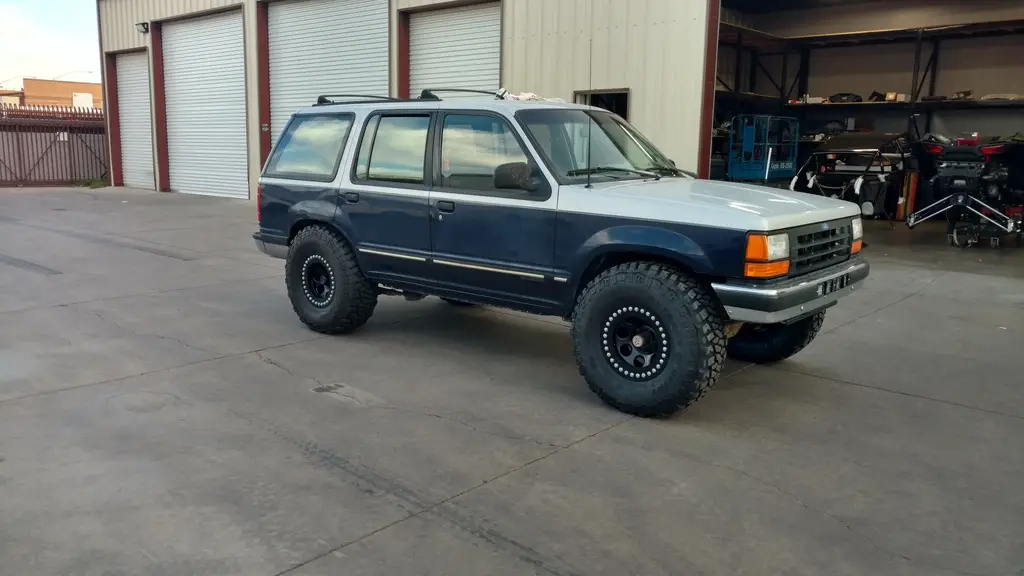

Blue Balls is my 93 expo. All started with a 94 I received from my father that I later toasted the transmission in. In need of a new trans I bought the blue 93 for $500 with a bad motor (dead cylinder). It was in much better shape so it instead, got the heart out of the 94. It's definitely nothing special, stock suspension on 35's,with no body lift. Tons of little odd ball modifications I make to it.

Hmm neat. I see some trimming there. I like the color combo. I feel a lot better about 32's with 2" lift now :)
That piston is pretty chewed up.

What's your axle gearing? Auto trans, or manual?

Most definitely a lot of trimming and smashing. Front bumper is moved up 2-3 inches, also trimmed back an inch or so. Pinch welds have all been folded over and front fenders trimmed. Rear fenders have been cut/rolled, still rubs the inside pretty good at flex. Gears are all stock for now, she's not very quick.... Auto trans. Will end up getting the lowest gears I can find when it gets a new rear end.

35's. 315/75r16 No lift, Decent amount of trimming and smashing and that's about it.
