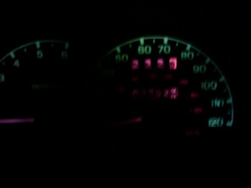

alright so strangely enough, a couple of months ago from 0-40 went out on my speedometer....i figured it was just a dead bulb...about 3 days later i filled my gas tank up and turned on my lights immediately after, and for some reason it went back on....i went home and turned my car off...the next night it stopped working again and still does not work...can it be the bulb?
If it is the bulb....is it worth replacing?, because i was thinking about getting gauges from speedhut.com...are new ones worth it? i want mine to light up red to match the neon i have. but then i would need new needles right? and how easy are those to install?
Sorry for all the questions lol. Theres also a pic below...

Just a bulb- 20 minutes to replace, that would drive me crazy... :)

If you take the dash apart to replace the bulb, you may want to consider taking the opportunity to replace your stock incandescent bulbs with LED's. Much less expensive than getting a replacement white-face cluster unless you luck out at the local pull and save. :)

i agree, replace them all with LED bulbs, it even looks so much better,
but no, id just go with the "reverse glow" gauges from eBay, they totally bypass the stock lighting, but it might be the bulb, might not.
the one that does my volts, and temp gauge's went out (i thought) and i took the gauges apart to replace it, and simply pushed it in a tad and it worked again, so try that, but if you can, get the LED's, get them on eBay theyre like 5$ for a set of 2, so its not even bad, you probably need about 10 or 12, but dont mark my word lol
