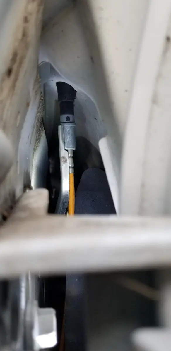

Hi all! One day I noticed my antenna was gone off the passenger side fender. I figured it loosened up and fell out at some point. I ordered a new OEM replacement from eBay, this part #
Genuine OEM Ford Antenna Mast AL8Z18813A​
It would screw in. When looking down the hole, it appears there's no threads, as if the old piece may be broken in there. I can't a way to take off the piece where it mounts/screws in to.
Frist off, is this the correct part I ordered? And second, how do I go about getting in there or somehow pulling the mount up out of the fender from the top??. I can see thru the passenger side door in the fender well, but just to look. I attach pictures from that view. Thanks in advance for any help and assistance!!

The antenna screws into the top on the outside of the vehicle. I will post pictures in the next post.
That should be the right antenna. Take a bright flashlight and look down the hole you should see the threads. If not take a piece of wire and stick it all the way down mark where the top is and compare the length to the new antenna this will tell you if the old antenna broke at the threads. If the antenna broke off then you could try to extract the broken piece just like a broken screw or replace the mount.

Thanks, do you know how to get the mount off?
I do not know exactly how it removes. I looked at my car and from what I can tell is you remove the wheel well liner and that will give you access to the two bolts that hold the bracket to the inner fender. then the assembly will drop out through the bottom.. The only problem is the wire that goes all the way to the radio. you will need to remove the center dash bezel and the radio to unplug it from the back of the radio. then you will need to fish the wire back through the dash so you can remove the assembly.
The only problem is I have no idea where the wire runs out the the dash at and if anything else will need to be removed. everything that I mentioned is fairly easy to remove except the wheel well liner. The body clips that hold it in can be a pain to remove and you make break them. The center dash is really simple to remove and well documented on here. I would recommend you don't unplug the passenger airbag light in the center bezel it may cause an airbag light to come on. You can just set the entire bezel on top the of the dash to get it out of the way for the radio removal. My best advice is to start with the center dash and radio and see where the antenna cable runs then go from there.
6L2Z-18A984-AA this is the part you need. Looking at the parts diagram there is a connector outside the dash so there is no need to remove the dash to replace it just follow the wire from the mount to where that connector is. my guess is its around a foot or two away from the mount.

Thank you, yes that looks like it, but getting inside the fender where it's mounted is the problem I'm trying to figure out.

As I said in the other post you have to remove the passenger side wheel well liner and then you will have access from the wheel well to the whole assembly.
