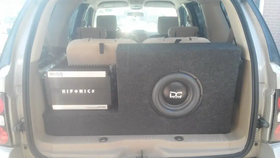

i didnt do the firewall i ran oversized 4 gauge through a floor plug under where your left foot rests while driving but when i moved up to oversized 1/0 i ran it back to under the drivers side 2nd row seat and did a 1 1/8th hole saw and grommet.... the size of wire you choose will change up the game plan

Dammm big enough amp and box lol
Couldn't have that here cops hear it one time
But very nice install clean

it wasn't that loud and just because you have it doesnt mean you play it 100% full time just about 2.351% of my music has loud bass

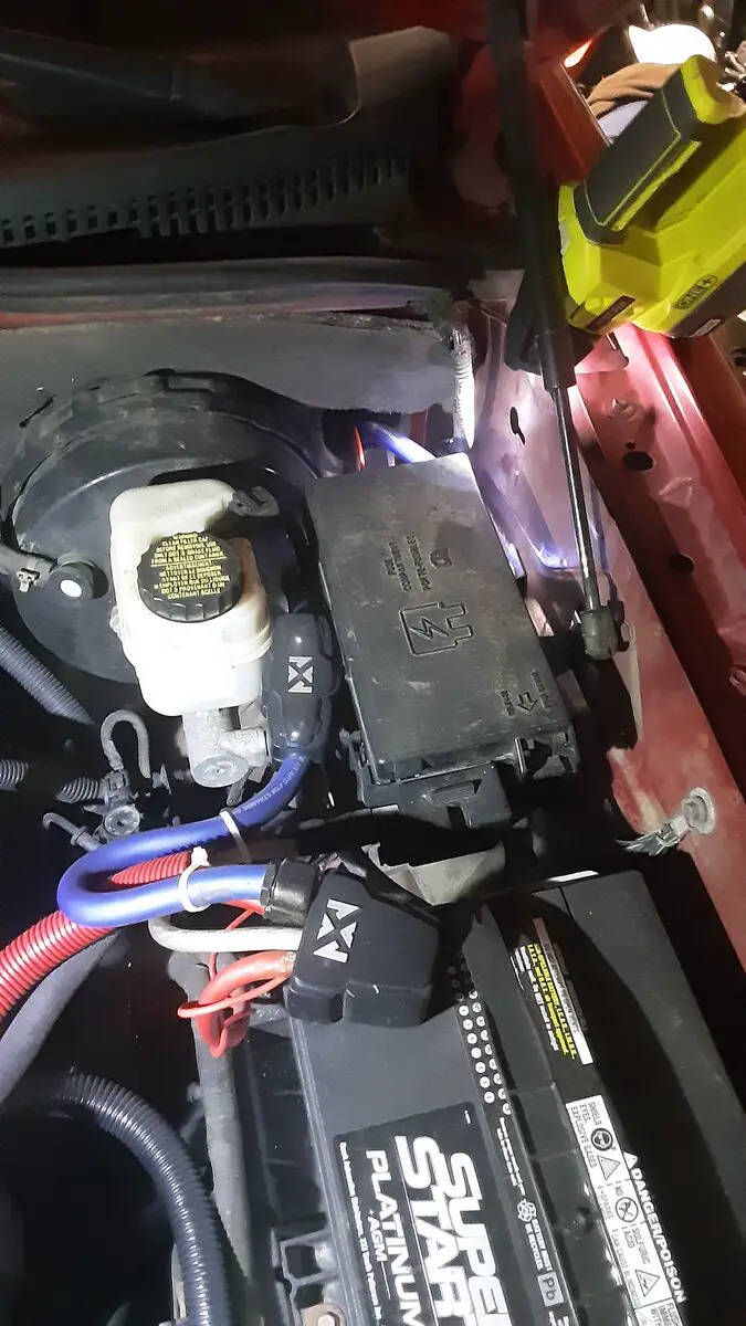

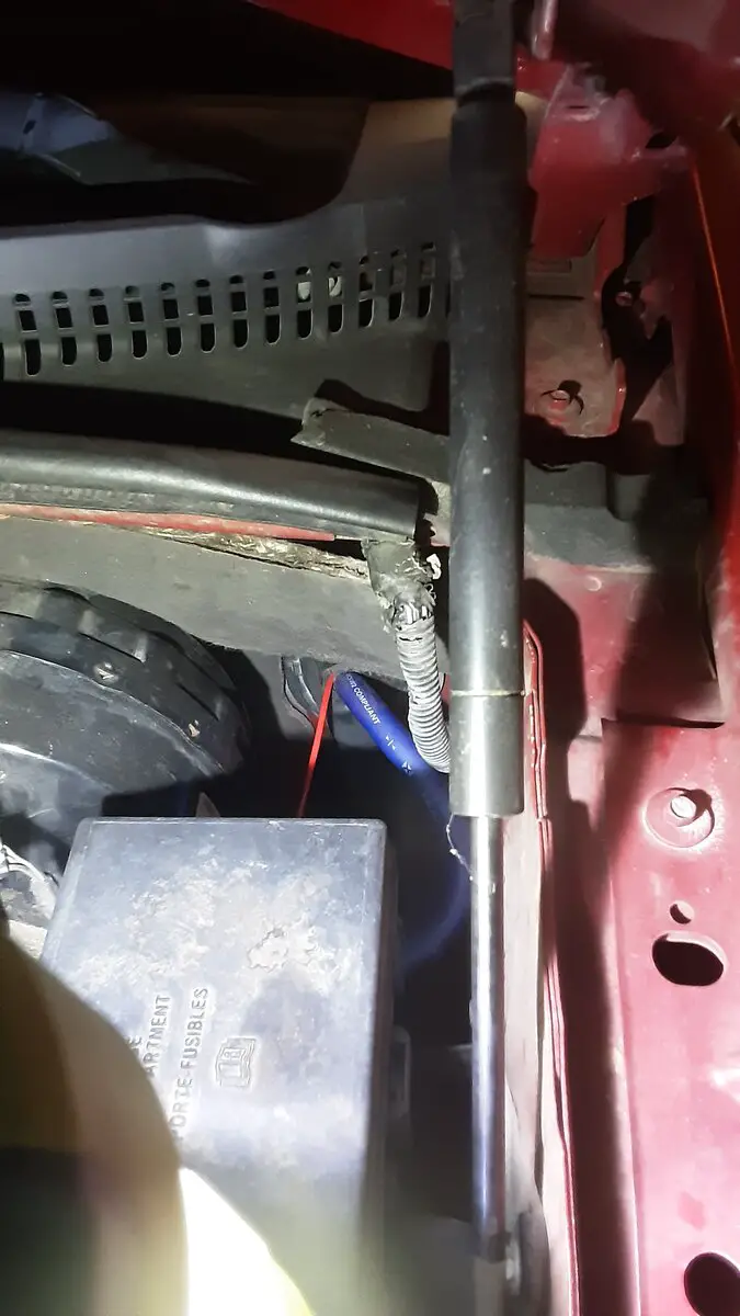

As others have stated use the big rubber grommet on the driver's side firewall. Use an awl to poke through at the top, be sure to check the inside so you are not to poke into any of the wiring. Get a small pvc pipe that the wire will fit through, grease it up with some silicone grease push the pipe through and feed the wire through. Then you will have a water tight sealed passthrough.
