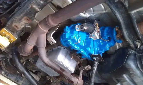

For the record trans is painted grey and transfer case ford blue+want to paint diffs blue as well then @ 115k my whole drivetrain has been replaced/remanufactured
IMAG0510 by billyssingle, on Flickr
Also.... The oe steel pan had a large doughnut magnet in it to catch debris that cannot be reused on aluminum nor can be just tossed in... Here's my solution with the same magnet but on the bottom of my external filter.. I've wheeled it its not coming off
