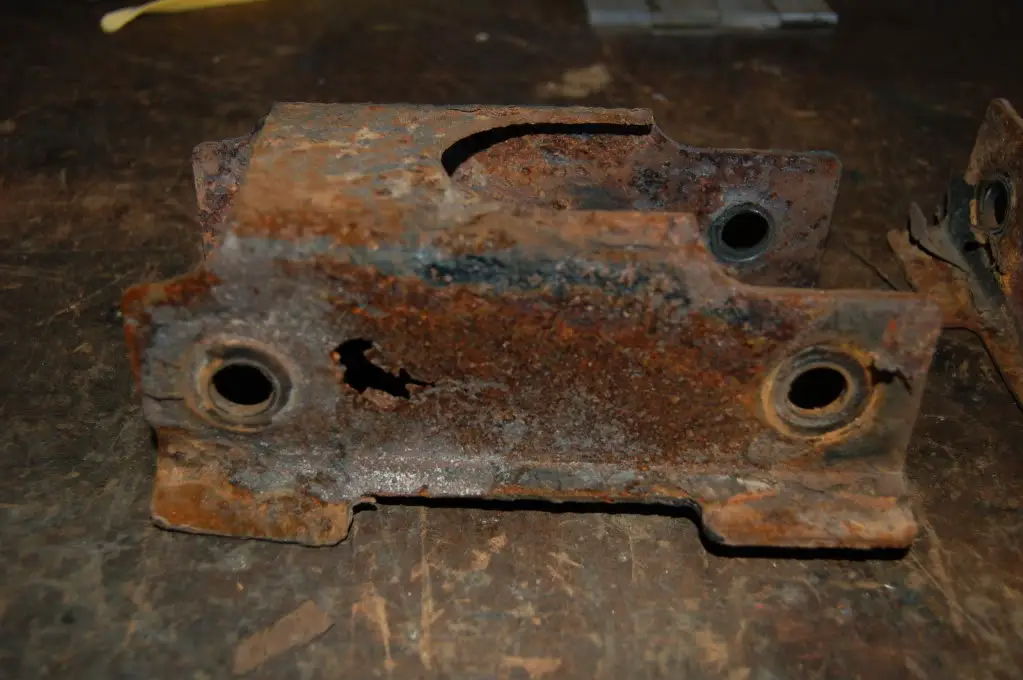

As for the running board conversion, I started that whole project because the rocker panels and dog legs were rusting out. So, I spent around $2,000 in that. I bought and replaced the panels myself but then had to pay a body shop $1,500 to paint it... Most of the work done to my explorer has been in labor. Cleaning, waxing, undercoating, and detailing is esentially free and that is what makes a vehicle look so much better than most others on the road.

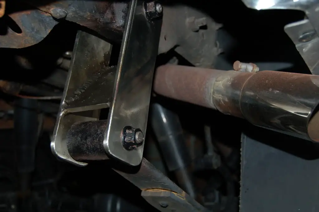

The most recent mod that I just finished was building a custom set of rear leaf spring shackles. I didn't want to pay for a set of warrior shackles nor did I want a full 2 inches of lift. Mine are made out of 1/4 inch stainless steel strips. Overall lift from these shackles was about 1 inch. From center to center the holes are 7.5 inches apart compared to the stock ones at 5.5 inches.
As you can see in the pictures I put another piece of steel on a diagonal between the 2 vertical pieces for support. To be honest I only drilled the holes and tack welded them together while my dad took them to work and had a friend finish welding them. I'm very happy with the way they turned out!
The stock ones were in pretty bad shape anyhow

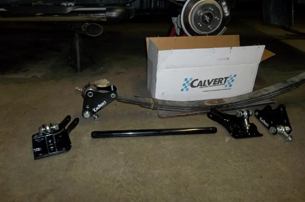

Even with the stock V8 traction bars the wheel hop was too bad to leave it alone. I invested in a set of CalTracs traction bars from Calvert Racing in California.
Install went really smooth. Hardest part was taking the leaf springs off and having the aluminum bushing pressed into the front eye (I had a local spring shop do that for me).
I am very impressed with the results, no more wheel hop and pure power off the line. It drifts like a king as well ;)
Calvert modified a set of stock explorer shock mounts
A machinist friend of mine slotted the bushings to help retain grease
I would recommend these to anyone!
