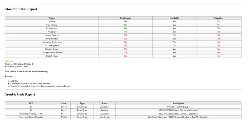

new code
system lean bank 1

new code
System too rich bank 1

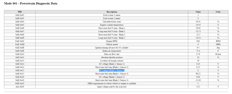

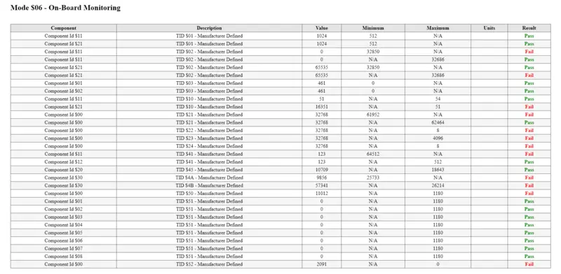

I have data from mode $06 I'll attach it if I can

If I get this .HTML attached, (well that's a bust)
overlook the data for O2 voltage (Bank 1, Sensor 2)

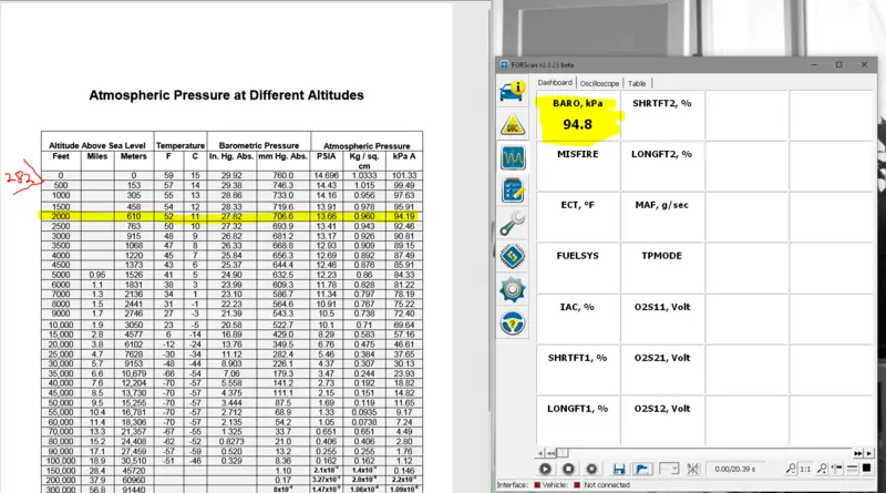

Well I think I am on to something here. (like I haven't said that before) I think I got a defective MAF. I hate getting factory defects, it can sure mess with your brain.
My elevation is 282 above but the baro is saying I'm at 2000 above. that could do it. I'll let ya know
So another $120 and it's still rich. sooner or later I'll stumble onto the reason.
