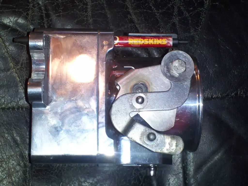

I dropped the Throttle Body off for Tim to perform his magic on. His 5.0 Sport looks even better in person. The motor swap looks like a factory install, body is perfect. Beautiful truck.

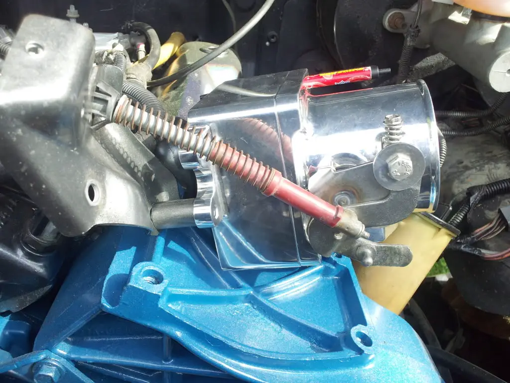

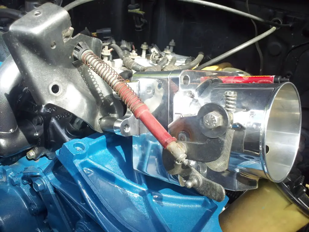

Interesting JD. That just might work. What I see there looks like it would give adjustability (If thats a word) to the whole assembly till you had it right.
it looks like it will work,i dont have cruise so i can trim that cable bracket also.its dark now but tomorrow ill pull that bracket off and trim it.ill mount it all up and see if it works

So? What have you been up to all day JD? Not done yet? I'm just out of bed. Late night working for me. Have to do it again tonight. I think you have a great solution there.
