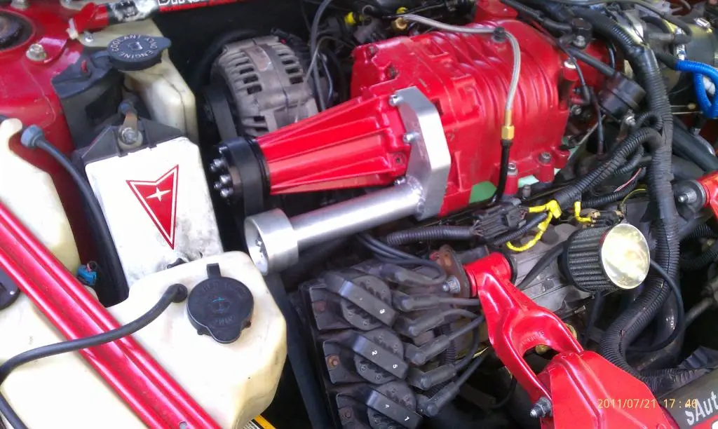

The one for the sohc won't work.that was the first one i looked at,the heads and assesory brackets are totally different on ours.what i did find is both of our chargers use the same snout bolt pattern .the ford is two inches shorter.you can use the same belt wrap im going to .you would just need to cut it down a 1.5" and redrill/tap it from the looks of it.pic of the two snouts
Cut, drill, and tap what?
The belt wrap kit im going to be using.its made for the gm snout so its 2" longer.they both use the same bolt pattern for the snout where it mounts,so it appears he can just cut it down for the shorter ford snout and it would work.we cant seem to find one made for the ford charger,maybe belt slip wasn't as big as an issue for them as it is for the gm charger.here is a pic of it but on a car,i haven't gotten mine in yet.

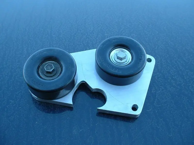

Here is what Ron made at BansheeSupercharger for the SOHC's.
I'll have to have a close look at mine and see if he is mounting to the block, or the heads.
I understand the block is very similar, so with the picture I should be able to eye it up.
If I can find some aluminum, I might be able to make something like he has done if the mounting points dont look like they will fit the ohv.

There really isn't that much that is similar at all.the whole front is completely different.we don't have that bracket its mounted to and also our water neck and tensor is right there.from what i can tell there is no room at all for it.
I havn't had a chance to look yet, but I'm sure your right.
Shoot i hope im wrong and you see something i don't,would be a nice easy fix for both of us and both type of motors;)
