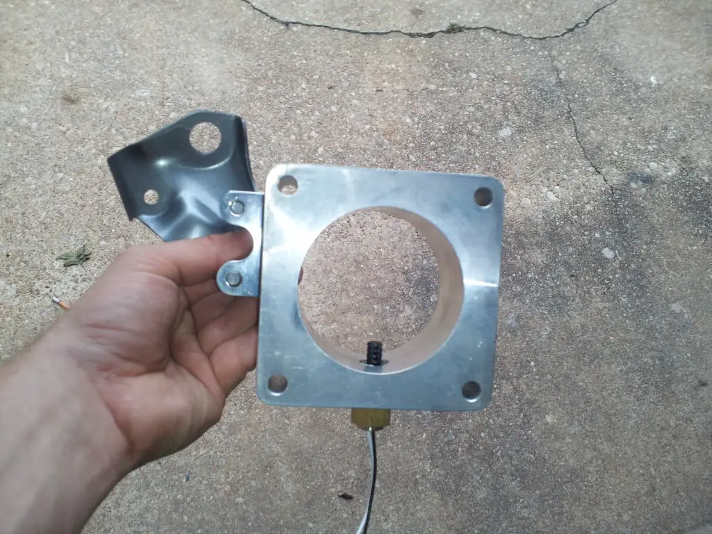

Look what showed up!
Im looking at install instructions and they say to install the spray nozzle just before the throttle body plate. If I don't, I apparently need a solenoid upgrade to prevent syphoning.
So, what are the draw backs of installing the nozzel pre throttle body?
positive would be a great atomization of the mixture. Would it be a posibility to worry about rust?
I see no way yto mount that container. No room at all.
Im even struggling with a clean place to mount the pump.
The second gen's dont have a rear wiper container. Id also be worried about a long run of hose causing other issues down the road. I still think I'll be cleaning out my front washer container and tapping in to it.
i would get the upgrade and mount it in the tb plate.thats where i have always mounted them at.personally i think the up grade is a scam but safe than sorry.i just cant see with as little vac as we make that it can suck all the way back to and through a solenoid,and then through a pump.like you said the atomization will be better and you wont have to worry about puddling.RUST???????whats in there thats not aluminum and it should never puddle.
