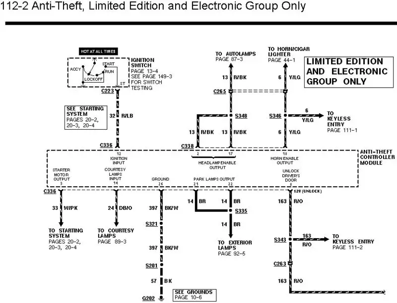

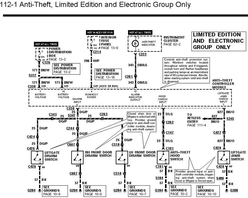

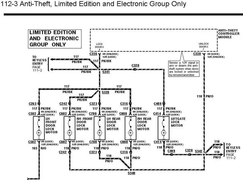

One of our back windows leaks and our anti theft module got wet, trying to find a replacement is proving to be a major pain. It started with the alarm randomly going off and now the truck just will not start - power to everything, but it will not turn over. I've tried looking it up on Google but to no avail. Does anyone know how to manually bypass this without spending a bunch of money? Or even to clear the code from the brain so maybe it will start?
