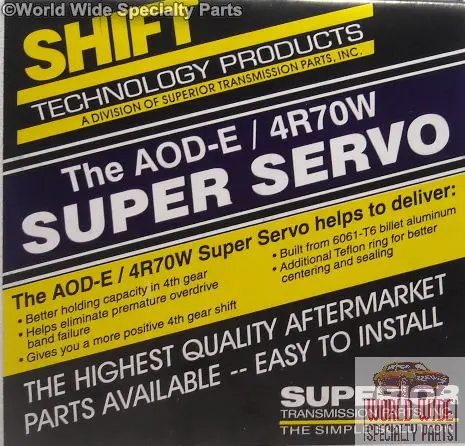

Dropping the the valvebody this weekend in my 96 5.0l Explorer and I was contemplating on whether to install this oversized OD servo or not. I tow 6,000lbs +2,000miles often with it.
Anyone have any first hand experience before/after of the increased shift feel on 3-4 engagement. You can install a washer and make it shift even harder. I imagine like a WOT shift into 2nd, but have no real clue if it would even make a noticeable improvement.
Interesting, I didn't know there was room for improvement of the 4R. Which part is it exactly that is being made bigger. I'm used to the old AOD's and their OD servo/piston/spring.
It is a 2.7 Overdrive Servo. I believe ours have a 2.5 with a sleeve. They also sell an adjustment pin. Curiously it does not come with a spring. I was thinking, why not just remove the stock spring like you would with 2-3 accumulator to make it engage faster?
TCCOA says the 2.5 is good up to 300hp, but that was figured for a car not a tow truck.
I had this ordered just a bit ago on ebay and then cancel it. Decided to see how it behaves with the new valvebody first. If 3-4 still feels a bit clunky, I’ll put it in on the next fluid change and set the adjustment pin to maximum and see what happens.
This transmission suffers the same pin bore wear as the 5R55S/W. This is just a bandaid. The only way to make the circuit correct is to bush it back to OE spec. Don't want to remove spring on the sevo not the same function as an accumulator. It uses fluid pressure on both sides where the accumulator works more like a shock absorber. Adjustable pin may be ok but I feel you may just be compensating for band and drum wear. JMO.
I gotcha, and that should match the size of the 98+ 4R's, which I think have no outer sleeve? It's been years since I looked at the parts inside a 4R, and lost touch with the guru who spent a lot of time on the SCCOA forum. I just haven't gone there in a long time.
Thanks for the input transman. I will leave the OD servo alone. My trans has 62,000miles on it. It's not acting up in any way, just want to get it shifting the best it can and fix any common problems with it.
