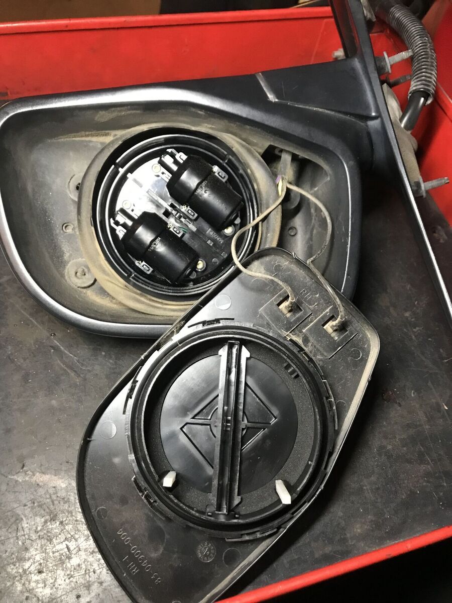

Was a little worried taking apart my heated mirror but I went ahead.
Was able to get the glass off without breaking it but some of the clear plastic peeled off and I am pretty sure it may be damaged. I’ll put 12v to it though to see for sure.
The glass is glued on at the factory with some serious stuff. It’s clear, maybe silicone?
The round part with the teeth came off when I took it apart so hopefully I can get it back to where it belongs.
Here is mirror off, the round part stayed with the mirror.
Here is the mirror glass removed. Tiny screwdrivers and slow, even pressure did the trick.
Here is the back of the heated mirror. Notice some of the clear plastic peeled off and I can see some copper showing as well. Not sure if mirror is still operational as a heated mirror or not.
One thing that I can confirm, that I was very worried about- the backing plate behind the glass is indeed flat. I was concerned that the backing plate would be curved as well, meaning that the flat glass would be difficult to attach to the curved backing plate.
But upon initial inspection, the backing plate appears flat, and the glass itself appears to be the only curved part. Above is the backing plate. Didn’t put a straightedge to it yet but it looks pretty straight with the naked eye.
Above is the mirror glass, again no straightedge yet but it appears to be curved to the naked eye.
All I need to do now is to locate a heater pad that will fit, and install it between the backing plate and new flat glass that is on the way, then wire it up and install it.
