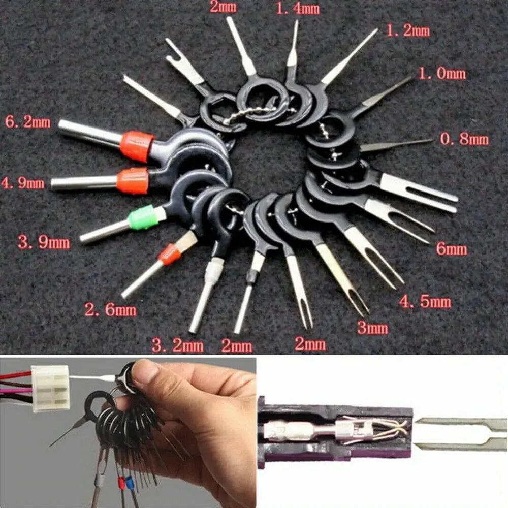

Seem pretty cool / handy......(good advertising/targeting youtube).........my next must-have for tool collection:
Amazon product ASIN B09STDQKQ3
Yes, I have two sets, they work great. Used them , when I replaced shift motor. And on a small 4 pin barrel connector
I have a plunger style for molex 4 pin but for everything else, just use dental picks, needles, or a piece of spring metal from a wiper blade.
Remember that a lot of Ford's connectors have a plastic insert (often a different color plastic) that you remove to get the contacts out, may not need special tools besides a thin bladed screwdriver to pry or needle nose pliers.
