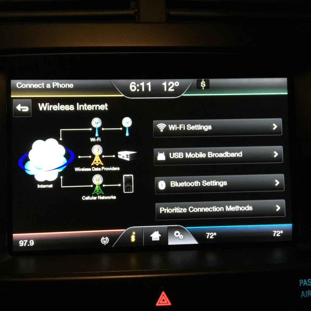

Anybody using this feature? or know what it takes to get it going properly?
Sorry if this has been covered before, I looked at a bunch of threads and cant figure out what needs to be done.
This has been discussed before. Very little usage since most cell phones can share internet plus MFT supports only a couple older USB broadband devices.

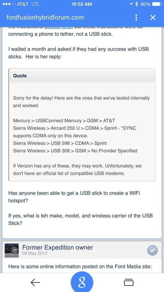

If I locate a "mercury connect" usb modem, will it work as intended?
Thanks
If it's through AT&T it should work, but I suggest testing it prior to purchasing just to be sure.

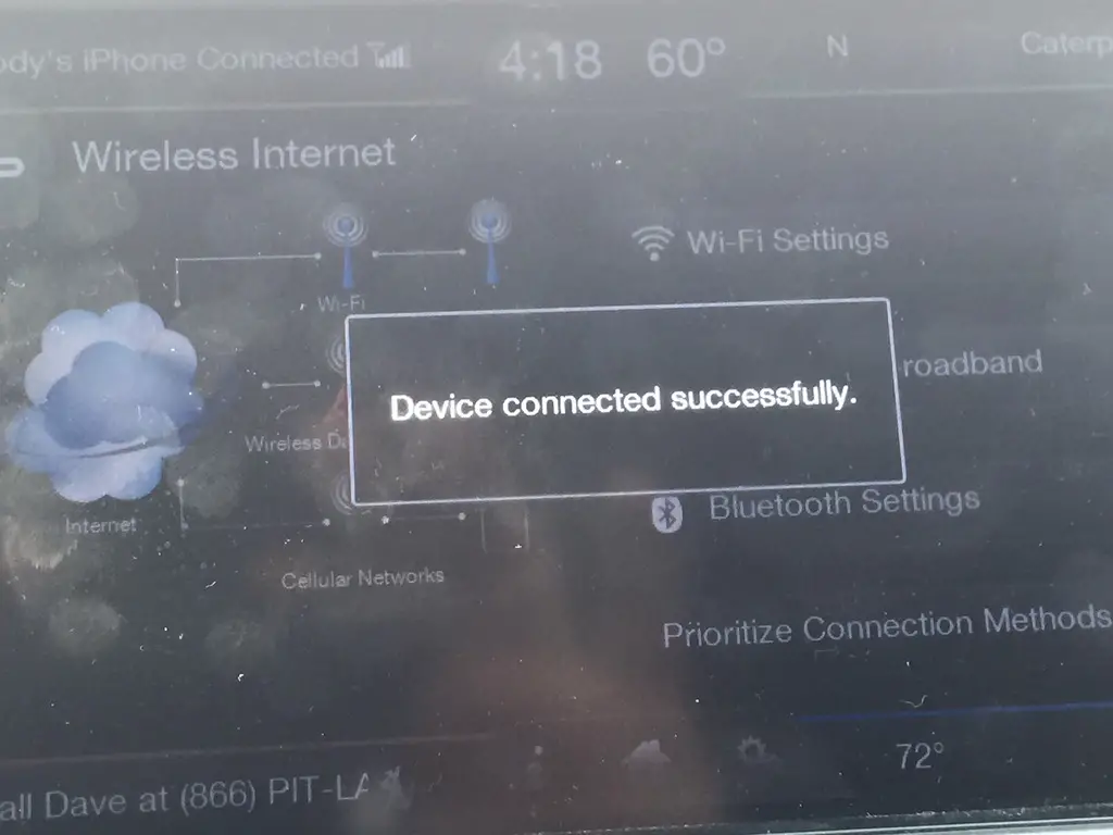

I'll post back with my results.
Scored one on Ebay....
