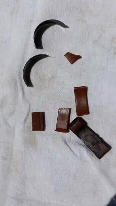

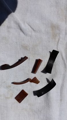

All,
I found these timing chain guide parts the other day when I did a pan drop on my '98 SOHC 4x. I am not sure if they are from the primary tensioner or the balance shaft. The brown pieces are plastic and the two black curved pieces are metal, like spring metal. Once ID'd, anyone have any input on how to proceed? More than likely an engine pull and fix all the guides, eh? With 200k on her I'm not sure it's worth the trouble. She starts fine with minimal rattle and once oil pressure comes up she runs flawlessly. No rattle at all when idling. I'm using Mobil-1 5w-30 Hi-Mileage with changes every 6k as a preventative measure.
Thanks for any feedback.
