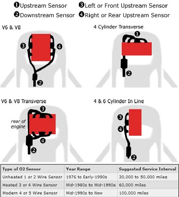

Hey guys and gals! I've got a '96 4.0 XLT OHV Exploder (yes, Exploder), and I am getting crappy fuel mileage. (around 11 to 12.3 in town) I am thinking it might be the O2 sensors. They haven't been changed in at least 80,000 miles and I cannot remember if that was the upstream or downstream, or if it was just one. Looking around on some auto parts web pages the say "Upstream Left or Right" or "X Engine Code". I believe I've got two upstream and one downstream sensors. My questions are, is there a difference between left and right upstream sensors? Do I need to replace downstream sensor? What brands would you recommend?
I am not throwing any codes at this time. I have done a tune up of plugs, wires, coil pack, oil change, cleaned the MAF, throttle body, air cleaner, etc. I still need to do tranny fluid and filter change soon.
