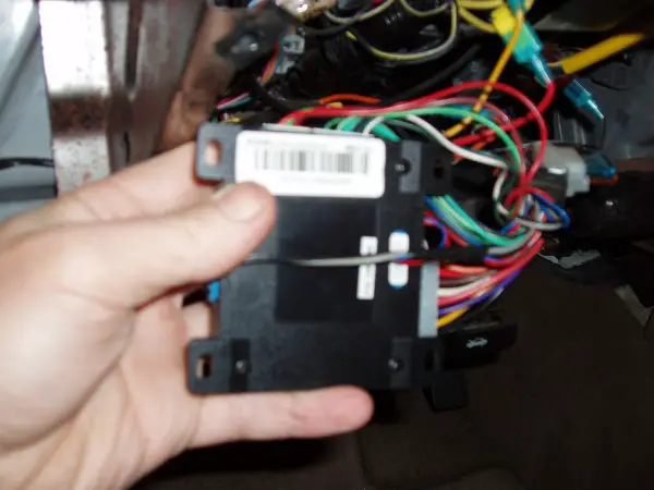

Behind the knee bolster?
Yup, on mine, the module is zip tied to the steering column, it was on top, a bit hidden, but I turned it in order to see the model

Heres a pic of the module that was behind the knee bolster...
