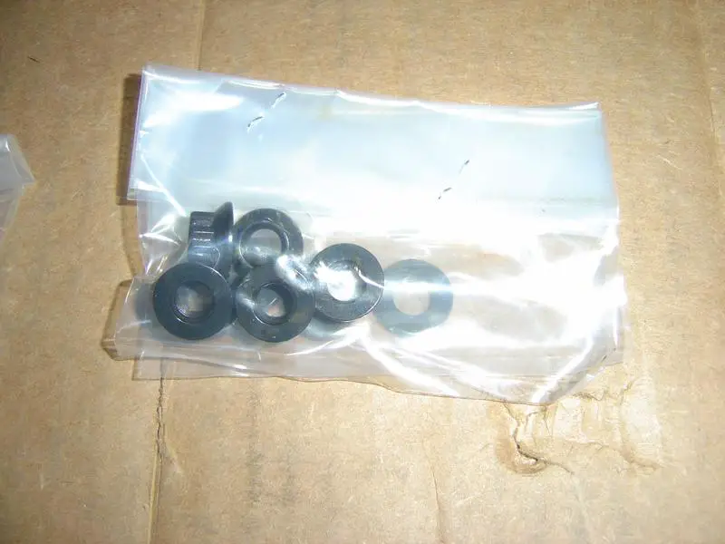

Since I got my ARP head studs so quickly I have no excuse but to do the job right and install the head gaskets and studs all at once.
The box I got is real pretty, I would have preferred a cheaper looking box and a discount. lol.

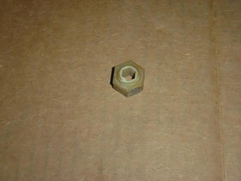

So I just started and the radiator petcock breaks. lol.
I hope the rest of this job doesn't go this way.

Radiator Petcock
Got a replacement radiator petcock. Pep Boys had it in stock along with all the other goodies I picked up today. I even had a coupon for $20.00 off.
I installed the petcock and it seems to fit perfectly.
Now it's time to get back out in the garage and get back to work.

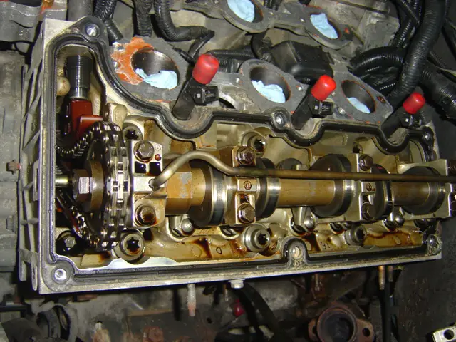

So last weekend I got it torn down to the valve covers. I had them off to take a look inside and found the engine to be pretty clean, out side of needing an oil change. I run Mobil 1 advanced 15,000 mile formula. The oil is supposed to be good for 15,000 miles or 1 year (after that the additives break down). I might hit 3,000 miles per year if I am lucky. I change it once a year unless something goes wrong that may dirty the oil.(like pulling the heads off).
I put both valve covers back on to keep dust and dirt out while I wait for some time off to work on it again. Probably be back at it Friday night. My plan is to have the heads and valve covers back on by the end of the weekend, if nothing goes wrong. I checked the fit of all the timing tools to make sure they would work with the engine in the vehicle, no problems so far.
I am definitely redoing the wiring harness, I altered it when I put the first supercharger on (m90). I don't like how it turned out so I am redoing it since I had to remove it to pull the heads.
