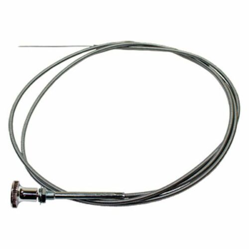

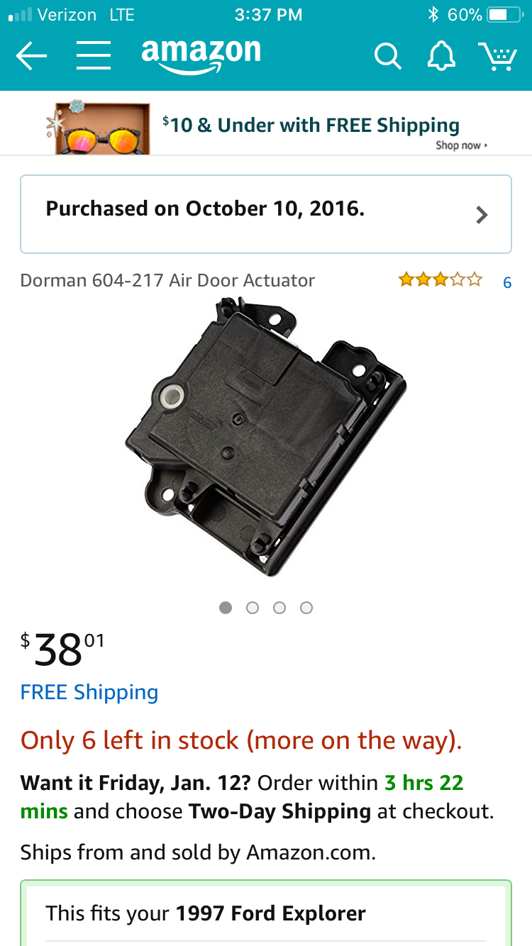

The Motorcraft actuator I liked (pictured in post #5 of this thread) does not have the same part number as mine (mine shows F87H-19E616-AB ATC and the picture in post #5 F87H-10E694-AB ATC) and the mounting holes are not the same. This actuator does say it will work in a 2001 Explorer w/automatic HVAC controls and while the exterior case of the actuator is a little different, it looks like it has pins that would go into where the screw holes are in my old actuator. I don't know if I can make this work and I don't want to take the chance ordering this part. I've searched the internet for my exact part number and I've found nothing, so I may be stuck having to buy the Dorman part. For now, both my EATC equipped vehicles are working with my baling wire fix. I just open the blend door for the winter months and close it for the summer. I'm even considering buying a universal push/pull choke cable to mount in/under the dash so I can control the crescent gear manually. Actually that sounds like a pretty good idea to me and would only cost me $10-$14 (see pics below). I'm not a fan of automatic controls anyway. Redneck fix? Yes.
Basic cable for $10:
