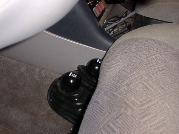

Nice job on the shifters. They look almost factory. Let us know how it went on the trial run.:D

After a few hours of a trail I've done many times before:
Wow. I don't think my BW 4405 ever provided this much traction up front. Now I realize how badly it would slip on the tough stuff. I was walking up stuff that I have had to spin a few tires to get up in the past. And I was only running 14lbs instead of my usual 12 in the tires.
It is very nice to be able to run 2Lo 75% of the trail and only engage the front when needed. Its also cool to be able to shift between Hi and Lo while moving, instead of having to come to a dead stop. Learning to shift the t-case with an automatic tranny took a few minutes of practicing, but after figuring that out, it’s a breeze.
And dang is it geared low. In 4th (1:1) at 2000rpm I'm only doing 11mph!! (According to my GPS) I was worried that it was too low while playing in the driveway because the slightest touch of the gas would make the tranny shift. But once there's a load on it (going up or down a hill) it shifts very nicely. I've got engine braking! Throw it into 2nd and she'll walk down a hill at 5mph. (and as soon as I fix the lack of engine braking in 1st it will be even better)
I'm now very worried about the strength of the front axle though. It complains even in the slightest turn, while engaged. I'm debating whether to put off a front locker until I do something crazy like a D44 conversion. I will definitely start carrying around parts that will get me back off a trail if I do break it.

I was happy to see the picture of the shifters next to the full size console! Looks like they will interfere with the seat moving forward tho, and knobs might hit the back of your leg. Oh well. The manual instructions are General and geared for JK's, not ours. There are no detailed instructions included for my application, and a few bags of hardware to figure out. Any tips for install, or did most of you pay a shop to install it? (I seen Jefe & Bro did it)
