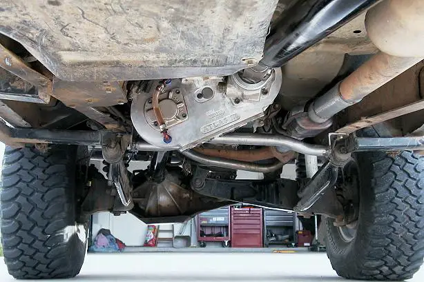

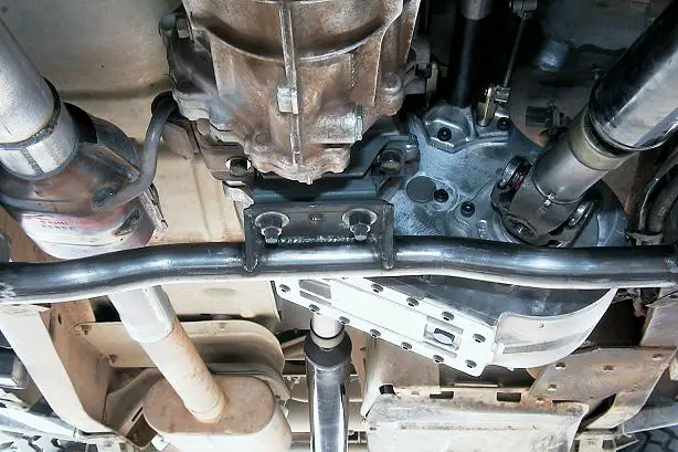

Here are a few photos:
This rear view shows the optional fluid level kit.
The custom crossmember made the installation very easy. This crossmember lowers the transmission and transfer case providing ample clearance around the case without need for modification of the floor or the need for a body lift.

Rick, Looks sweet! The drool is being wiped up as I write this. Dead Link Removed That Cross member is it big enough? Or are you going to have som sort of a skid plate added? Also is FST selling those? If so I want one! Dead Link Removed Or at least a price on one. That looks nice and beefy! Ohh man... Dead Link Removed

WOW!!! Look at that clean garage floor! And the tools are actually in the toolboxes! Dead Link Removed
Thats a great install on the transfer case. Interior looks great.
Out of curiosity, what is the blue switch for? Looks like some sort of antenna switch.
Hope you enjoy the new transfer case!
Ryan, the transfer case sits about 2" lower than the stock unit so I need to build a new skid plate. I'll ask Torrey if how much he would charge for another crossmember like mine. Do you have an auto or manual? i can't remember.
Weatherman, it is an antenna switch I switch between 2 different HF antennas.

I got the 5 speed. 2 inches lower would accually help me out. It would make the driveline angles better I think. Allthough I am not sure what that would do for my clearence under there.
