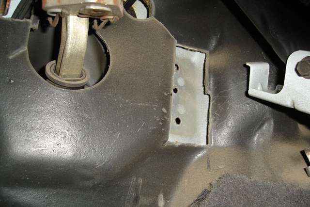

I was driving home a couple of weeks ago in the 98 Exploder and noticed the power wasn't up to snuff. Sure enough as I was driving home the entire gas pedal assembly snapped off the firewall:
The fix was somewhat easy. I just drilled out the spot welds and placed 3 locking nut/bolt combinations in there and off I went. Make sure to check this for fatigue or otherwise you could be losing HP and might be stranded on the side of the road.
