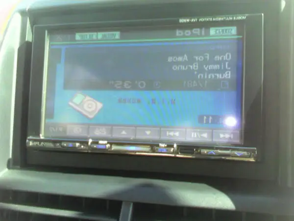

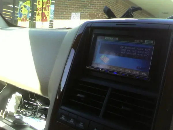

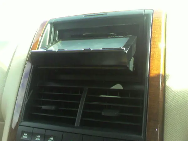

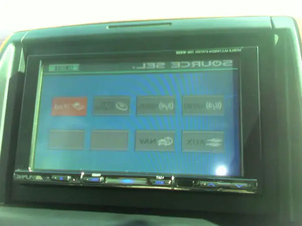

Any pictures of the W200 in the vehicle? I was thinking about getting this now that I found out I can retain my factory wheel controls.

Sorry these photos are so lousy. These are from my cellphone.....
The iPod is in the glove box somewhere...

Looks nice, thanks for posting. Did you pay the standard $999 or do you know of a deal?
