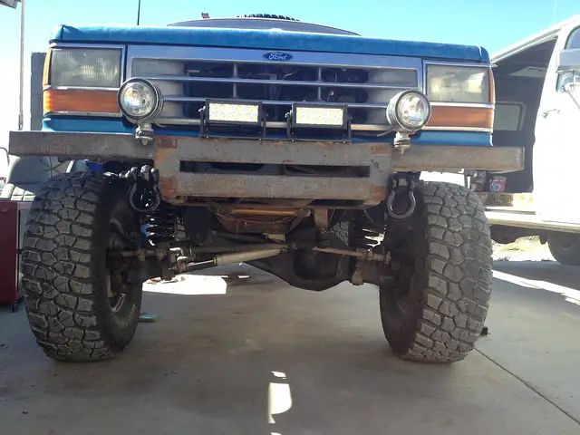

A cut/turned beam will also give you the angle which in effect raises the diff compared to using drop brackets and keeps it alignable.
Most cut/turned beams you can buy are cut/turned for 5"+ of lift though..
Here are a couple shots to show what 4x4junkie is talking about..
See how the beam is angled which makes the Diff higher..
Custom Tube bumper with d-ring and lights 1 by maniak_az, on Flickr
Here is a beam using drop brackets to keep the factory angle..
Front-suspension-shots 002 by maniak_az, on Flickr

Yup, C&T beams takes the process just that much further.
Sticking camber bushings and spacers in there alone still can be good for at least a 1" improvement, often 1¼-1½", given how low I see some stock setups sitting. If the truck ends up sitting nose-high, then a set of (longer) extended shackles in the rear should re-level it.
Agreed, looking at the video you posted it does look like you're pushing a wall of mud with the front diff.
