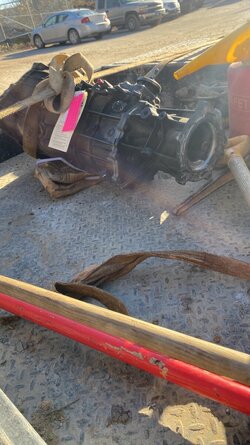

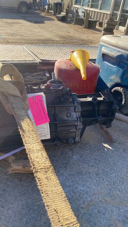

Alrighty I’ve been gathering information left and right for the past year or so about an auto to manual transmission swap. I have a 95 xlt with the electronic shift transfer case and the crummy 4r55e, I’ve recently picked up a 5speed manual from a 99 ranger 4x4 (4.0 ofc). I’m sure this transmission will bolt to my engine and transmission just fine but my biggest question or concern is will I need to make any adjustments? If anyone would direct me to someone who’s similarly done a swap like this I would greatly appreciate it or if anyone has any input or suggestions I will appreciate them aswell. Transmission attached
