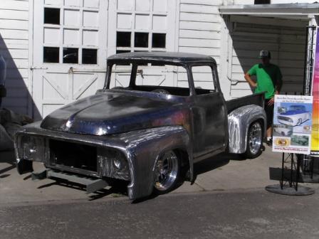

Ok, here's some pics, they are backwards though.
First, this is what it looks like after the chop.
2nd, during the chop.(yeah thats my beast of a b2 in the background)
3rd, before the chop. This picture made us decide to chop it, it really needed a chop.

Thats going to be a cool truck MOAB, shame it's not yours !
Wheels are a little too bling for me:-)

Looks like they pancaked the hood a bit, how far down they go ?
Thata very subtle chop, I like it. I tried to keep mine tasteful too, i don't want non-hot rodders looking at it and laughing (mainly my wife)

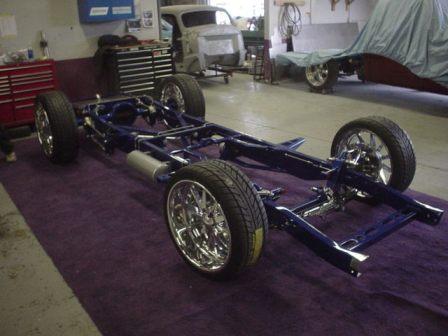

We actually went with a fully custom frame/rolling chassis. I'm not sure of the builder, it came from back east somewhere. It had most of the lines on it already, as well as rear 9" and front IFS. We airbagged it too. It came painted red, here you can see what it looks like now..
Oh yeah, on that hood....I'm not sure how much it is pancaked, but it is quite a bit. They had to redo it multiple times, I know it was the biggest PITA of the whole project.

Great looking chassis ! Keep me up to date on it. It's obviously a much bigger $ build than I am doing but it'll be trick as hell.

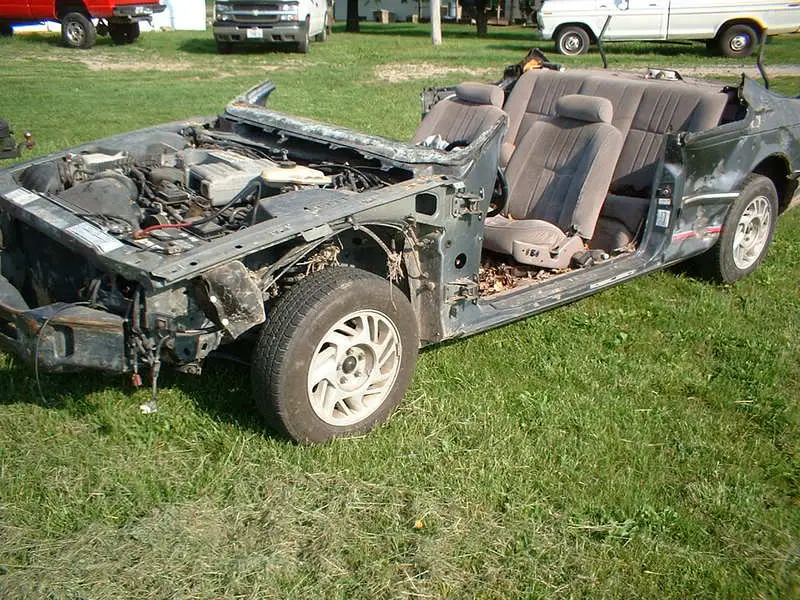

Finally I am down to the chassis - the bit I want to keep.
The Sawzall scores again, I chopped right through the floor at about the door posts then lifted the whole back section off. We sat that on the driveway and then cut it right down the middle to get into the back yard.
Sorry about the blurry pictures.

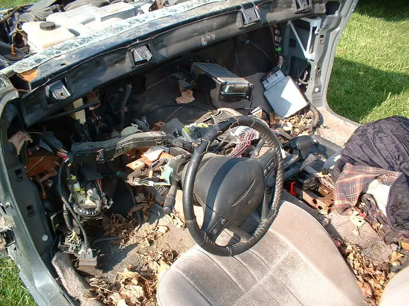

What is this white box? And depending on what someone says it is, do you still have it?
That is the keyless entry module, the five digit code is on the side of it. You have to use 95-98, or 99-01 models to interchange. There is a cable going into the 95-98 models, I have a 98 version extra.
