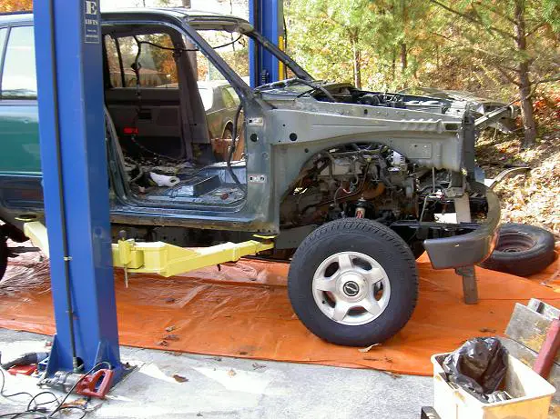

Well I cut off the last big chunks of Explorer bodywork today.
The radiator support I cut first, I removed all the wiring to further back in the engine bay and then cut as close to the firewall as I could get with hitting anything worth keeping.
I kept the radiator and the AC condenser all together and attached for simplicity, and that we might use the whole support.
After that it was just a matter of releasing all the lines cables and wiring from the firewall and lifting it clear. As it sits right now it's still resting on the frame until I get someone here to help me move it to the yard.
Sorry about the crap pictures.

Is that an outdoor lift your trucks on ? I've never seen that before.
Color is probably the only thing that hasn't really been nailed down in details yet !
The wiring will be the most tedious part of your project. If you maintain as much if the donor system as possible, then more will be plug and play, and less research will be needed. I started with a complete 99 Limited, but the body harness had been cut, so I ended up with a 2000 EB body harness. That alone caused a few hours of research to diagnose issues with the memory seats and air bags.
My lift is part of my project, included in my costs, and yes it's outside. I have yet to do any weather proofing, lots of odds and ends to finish. Regards,
