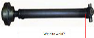

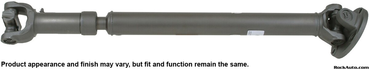

I have a 96 Ford Explorer 5.0 all wheel drive. When accelerating there is a vibration and rumble noise from under what sounds like the driver compartment. It also clicks like a u join down when turning and in Reverse or under load. I have replaced both CV shaft and wheel bearing with no change to the noise or vibration. I have also removed the front drive shaft and drove around, and without the front drive shaft there is no vibration or noise of any form. The vibration is at the same speed the vehicle is traveling and increases and decreases with it as well. The front drive shaft did seem a little rough and probably could be replaced. Although I'm having a hard time finding the correct shaft. On Rock auto they have two options available one with a u joint at the axle and transfer case and the flange at the transfer case like I have, but my drive shaft at the transfer case has a double cardin u joint with the flange. The one that rock auto has that has the same double cardin u joint does not have the flange. The drive shaft in the vehicle which measures right at 29 inches u join to u joint. I do not know the compressed length though. At just normal cruising speed you can here and feel the vibration but the noise and vibration are not quite as prominent as when accelerating. The front axle is full of fluid, although a while back the vent tube from the diff got quite oily for no reason that I know of. I have checked it multiple times since and it still seems to be full of fluid. I have also recently changed the transfer case fluid which did not look that bad, there were no shavings or metal that I could see. Any help is appreciated.
