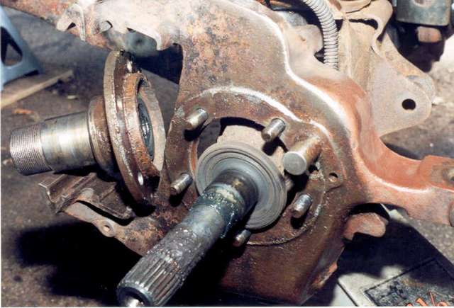

You will need to remove everything as Izwack mentioned to the point the stub axle shaft is sticking out like the pic below.. At this point you can just pull the stub axle out of the diff (driver's side) or out of the slip joint (passenger side). Check out Glacier's Brake diary for lots of good info on re-installing rotors, wheel bearings, and torquing them to spec. Also check out the U-joint links ink in my sig for info and pics on replacing them.
