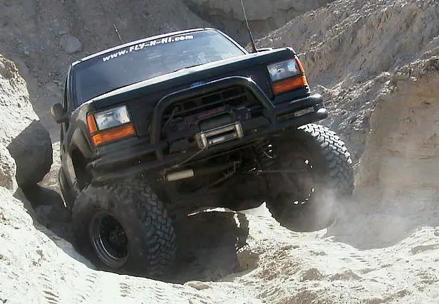

Unfortunately I was only able to participate for a couple hours on Saturday as I had a mishap early in the day. I followed Paul's Explorer and the Defender up a steep and narrow canyon with a dry water fall. The first ledge was a tight squeeze. I thought I was going to take out my passenger side doors with a rock wall, but my nerf bars took the hit and spared me from any body damage. I wasn't so lucky on the next set of ledges.
With my wheels cranked to the left I approched the first ledge in the series. Both lockers were on and I started to climb. Things were looking good, I was making forward progress and got on the throttle a bit heavier as I could feel all four tires begin to break loose. Just as the front tires made it to the top, the rear left tire hit the ledge. This is where my spring over axle conversion bit me! SOA conversions are more prone to axle wind up than SUA set ups. My axle wound up COLLAPSING the spring perches on both sides. This allowed the axle to continue to rotate which in turn produced more of an angle than the U-joint could handle. The weakest link broke which was the drive shaft flange where it attached to the pinion flange in the rear axle.
I was now stuck on the side of the waterfall. While I sat in the Explorer with my foot firmly planted on the brake a few of the guys got under my truck and un-bolted the driveshaft from the transfer case. Once it was disconnected the Defender turned around and ran a winch line to my Explorer. It took all his winch could muster to pull my 5500lb Explorer up the waterfall. I actually saw smoke coming from his winch.
That was all for me. I was now stuck with a front wheel drive Explorer and a 260 mile ride back home. Front wheel drive really sucked! I got stuck very easily in the loose dirt even with the ARB engaged.

Rick, I'm glad you got back ok. Nice shot of your truck. I got some more pictures that I will send to you, also Les (Toyota 4-runner)will be sending you some pictures via e-mail.
We did not go back on the trails this morning. We all wanted to get back home before the traffic would get so bad. See you again in Jan. for the BIG run.
Maybe we could use this thread to continue the topic. It starts with a picture worth TWO thousand words, and has Rick's summary of the pre-run, and the area in general.
